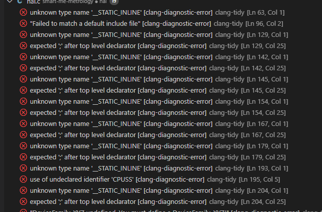

When we enable any checks in Clang-Tidy Settings number of errors is exploding. The erros listed are appearing randomly all over the code.
Is there any configuartion how to properly setup clang-tidy in CCS 20.3?

__STATIC_INLINE is a macro likely defined in the SDK and not picked up by clang-tidy, hence the error. You can explicitly define it in the compiler definitions. Another option is to define it in a .clang-tidy file. For the latter you would need to use CCS 20.4.0 (earlier CCS versions do not support a .clang-tidy file).
