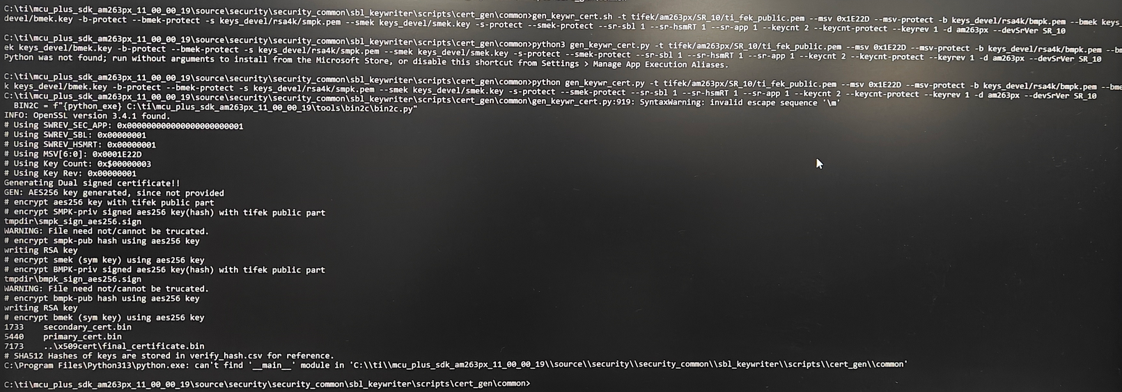

I am currently trying to build key certificate, while creating key certificate i am getting following errors.

I am using otp_key_writer_11. I copied the SBL key writer package to the specified path inside the mcu_plus_sdk (version 11) directory.

I am able to generate the certificate and the header file of keys, but I encounter the following errors when building SBL_keywriter.

The path of dev config.mk is not correctly set,in screenshot shared it tries to find it in source folder,
where as location is top level directory of mcu plu sdk
mcu_plus_sdk_am263px/devconfig/devconfig.mak
