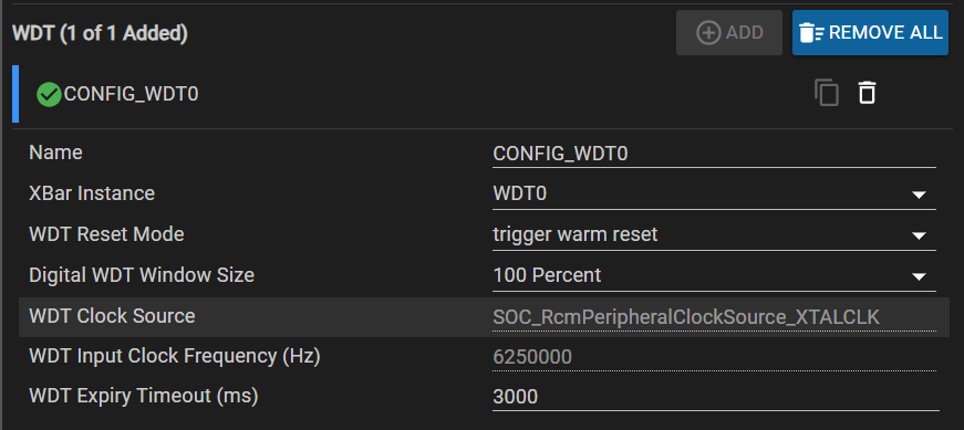

i have imported the working example of watchdog reset mode which have these settings
having 3000ms set with input clock freq already set

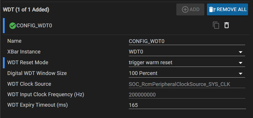

now i wanted to mimic this wdt to another working example i2c_led_blink (rtos)
but when i try to add the wdt to there mimiking the same numbers im not able to add 3sec time out . it goes only uptil 165
i see the clk source is diff and cannot be changed and the input clk freq is also diff and cannot be changed , please give info for changing and acheiving the same functionality here in the i2c_led_blink project as well.
