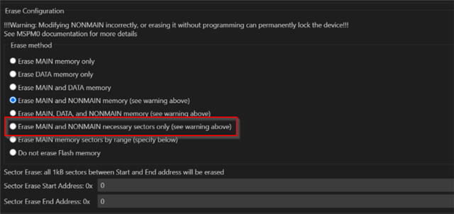

We are developing with the MSPM0G3507 microcontroller. Recently, our devices have been permanently locking, and a factory reset does not resolve the issue. We are unsure how to prevent this from happening.

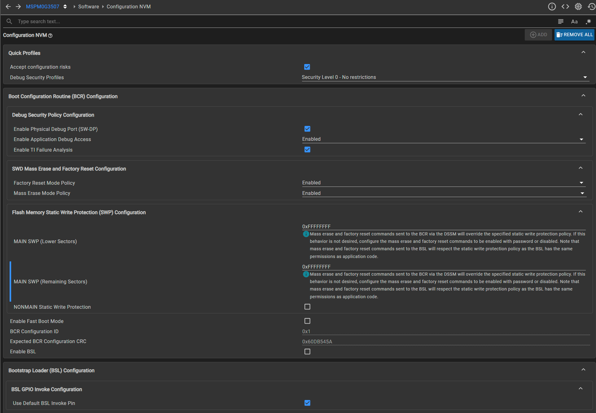

I am currently investigating this problem and would appreciate it if you could review our NVM configuration to identify any potential risks that could cause the permanent lock.
below is the screenshoot of the Erase configuration during debugging and the NVM configuration.

  1. Erase configuration: Our current setup may be incorrect. Should we change it to erase only the MAIN memory, or should we erase both the MAIN and the necessary NONMAIN sectors? Currently, we have configured it according to the Debug Security Policy. Does this mean that for debugging we should select both MAIN and NONMAIN, rather than just MAIN?
  2. NONMIN static write protection: Should this be enabled in our configuration?

    I see you disable BSL and other remains the same. It looks no issues. Try below approach to recover:
    If you enable the NVM in the SysConfig tool, then you need enable erase NONMAIN in the project property.
    From my perspective, below setting is more often used with my self debug experiment:
    This setting only erase NONMAIN if your firmware include NONMAIN region. If no NONMAIN exist, it only erase MAIN region which has data in the firmware.
    This need be disabled if you want to re-program the NONMAIN, unless you need do factory reset to configure NVM again.
    For user debug activity, after the NVM is configured and does not need change, I recommend user disable NVM in SysConfig in case in new program process, there accidently has power loss or SWD connection loss breaks the new NONMAIN firmware loading. Then an empty NONMAIN results in a permanently locked state.
    If I disable the BSL but choose “Use default BSL invoke pin” under “BSL GPIO configuration,” that means our device will not enter BSL even if PA0 (default invoke pin) is invoked.
    I have seen in NVM configuration — for example, configurations like SWD mass erase and factory reset — that once configured the first time, during subsequent debug or flash processes, I could remove all NVM until I needed to configure it again. Am I getting this right?
    Yes, that is correct. NONMAIN will keep your last settting if you don't configure it.

    Or can I just keep the NVM configuration and simply choose “erase MAIN and NONMAIN necessary sectors only” when debugging to avoid permanently locking the device?
    No, this only control the erase behavior, but not control the program behavior.
    You can select this erase property, but you need to disable the NVM configruation, or you can exculde it from the compiler and linker.
    Then no NONMAIN firmware exist in your .out file, and NONMAIN is not erased and program again.
