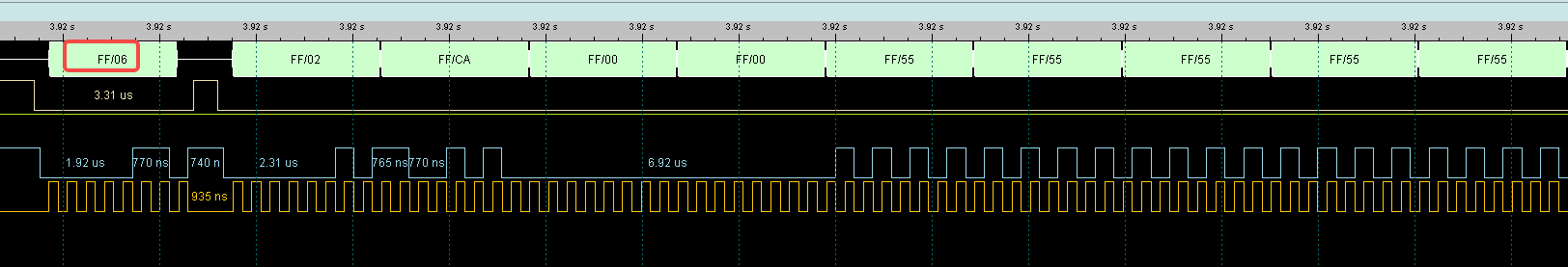

Hello TI support team.
When analyzing the data writing instructions in flash, it was found that there was an extra "06" instruction.May I ask if this is the default behavior of the chip? As shown in the following figure:
Bruvin Lu.
  • Hi Bruvin,
    The 06h command you're observing is the Write Enable (WREN) command, which is a standard and expected behavior when writing to flash memory.
    Why is this command necessary?
    The OSPI controller automatically sends the 06h command before any write/erase operation to:
    1. Set the WEL (Write Enable Latch) bit in the flash status register
    2. Enable write/program/erase operations - Flash memory requires WEL to be set as a safety mechanism
    3. Comply with JEDEC standards - All SPI/OSPI flash devices require this command before writes
    Without the 06h command, the flash will ignore any write/program/erase commands as a protection mechanism. This is default behavior and cannot be disabled - it's part of the JEDEC standard flash protocol.
