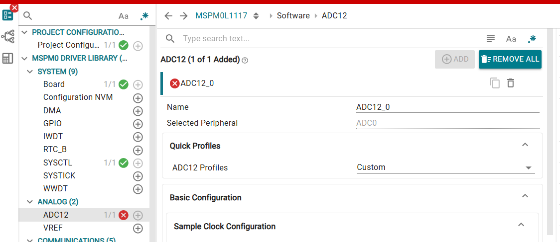

When using SysConfig with the MSPML1117RGE device, selecting ADC causes an error. However, when using a 32-pin device and selecting ADC, no error occurs. Nothing else is selected except ADC. What does this mean?
  • Hi Akira,
    That is due to your ADC pin assignment.
    ADC does not automatically assign the available ADC channels, you need manually select ADC channels used with their hardware, see below setting and check where cause the pin conflicts:
    The tools also share where cause the error:
    B.R.
    Sal
