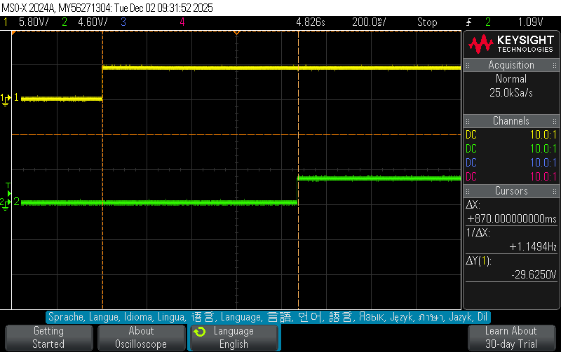

Hello TI team,
I am currently working with the following setup:
  • AM261x-LP
  • ICSDK_10_02
  • S7-1500-PLC
According to the TI Profinet documentation, the fast startup time should be 625 ms. I have followed all the recommended steps, including setting the device to “priority startup” in TIA Portal and building my code in Release configuration from CCS. However, I am consistently measuring a startup time around ~870 ms.
Could you please help me understand where I might be going wrong? I have attached links/photos for your reference.
Yellow line: Device power-up
Green line: first output profinet frame receive on device
Profine Device: PROFINET Device4.2.0 datasheet
Thank you for your support!
 Parag Vora
  • Hi Parag,
    I would recommend to use latest release using am261x_revA if possible, using default config from demoApp and MCU plus Sdk v11.00.00.29. Size of PN Config data stored in EEPROM is important and can increase startup time
