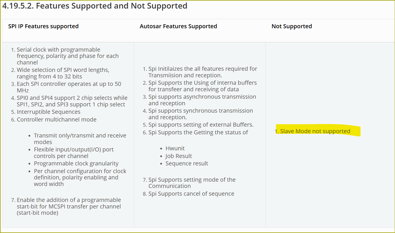

Would like to confirm if the am263p4 has a spi slave mode to communicate with another am263p4?
I see that this feature is not supported:
4.19. SPI — Platform MCAL Development - AM263PX User Guide
For your confirmation. Thank you.
