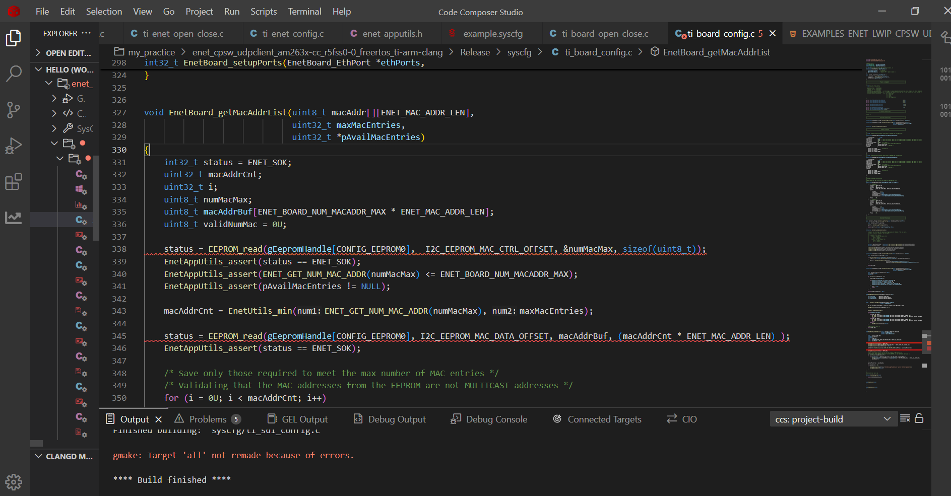

I'm using mcu_plus_sdk_am263x_10_02_00_13 and the example project enet_cpsw_udpclient_am263x-cc_r5fss0-0_freertos_ti-arm-clang. I changed the CPSW SysConfig setting MAC Address Assignment Method → Manual Entry and entered my MAC list, but after regenerating SysConfig the auto-generated board file still contains EnetBoard_getMacAddrList() which calls EEPROM_read() (I2C) to fetch MAC addresses. I do not want to use EEPROM for MACs — I want the manual MACs from SysConfig to be used.
Steps I tried:
  1. Opened SysConfig → ENET (CPSW) module → set MAC Address Assignment Method: Manual Entry and added MACs.
  2. Saved .syscfg and regenerated.
  3. Rebuilt, but the generated ti_board_config.c still contain EEPROM reads (EEPROM_read(gEepromHandle[CONFIG_EEPROM0], ...)) in EnetBoard_getMacAddrList().
Questions:
  1. What exact SysConfig setting(s) must I change so generated code DOES NOT call EEPROM? Is there a specific checkbox to disable the EEPROM mapping used for MAC assignment?
  2. If SysConfig cannot remove the EEPROM code for this example, what is the recommended way to override the generated EnetBoard_getMacAddrList() so the ENET stack uses my manual MACs?
