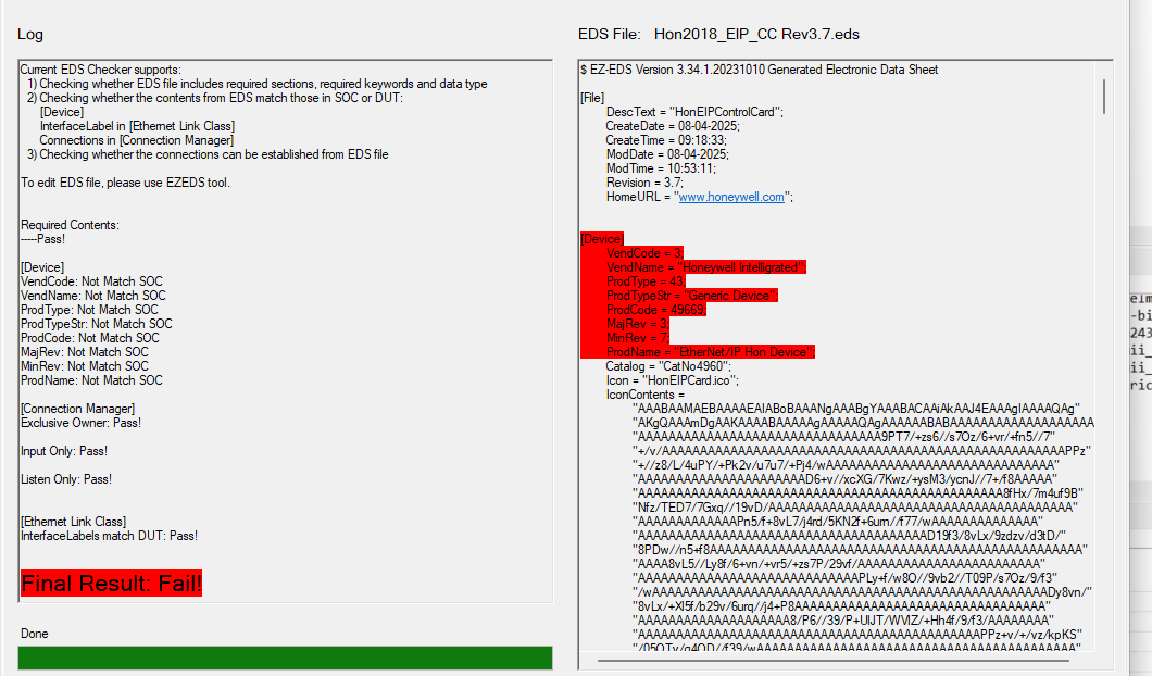

Hi
we are doing a conformance test on our custom board with am2434  ind_comms_sdk_am243x_09_02_00_24 SDK and I have attached the error, as per the previous suggestions we had updated the code with product_code, Product name, Device revision, vendor ID)
Is there any other things we have to take care or change in the code.
  • Hi Yashaswini,
    The error likely indicates that you haven't loaded your .SOC file. You'll need to adapt your .SOC file just as you did for the .EDS file. To do this, simply open your .SOC/.STC file via "STC Editor" panel -> Add -> (select your SOC file) -> OK (Add menu) -> OK ("STC Editor" menu)
    If you don't have a .SOC file, you can start from an EIP example as a template. For instance, the SOC file for a Generic Device can be found at: "ind_comms_sdk_am243x_09_02_00_24\examples\industrial_comms\ethernetip_adapter_demo\device_profiles\generic_device\soc\am243x-lp_tiEtherNetIP_freeRTOS.soc"
    Please ensure that your EDS file and SOC file are consistent with each other to avoid any mismatches.
    Pourya
