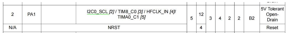

Can the MSPM0C1104 Reset pin I2C be multiplexed?
  • Hi Vayne,
    Yes, the pins can be multiplexed to a variety of functions that are defined in the device specific data sheet.
    This, however, does not mean simultaneous functionality.
    Furthermore, for devices where PA1 and NRST are double bonded, you will have to disable NRST functionality.
