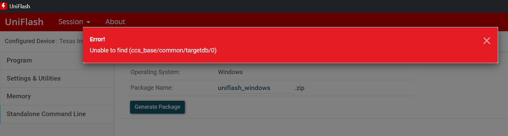

I use uniflash 9.3.0 and connect MSPM0L1117 evm.
when I click "Generate Package" in uniflash. It shows error below.
can I know how to fix it?
BR,

Hi Frank,
This bug is a known issue that was found in UNIFLASH 9.2, and the fix for it is slated to be included in UNIFLASH 9.4. The issue occurs when selecting the auto-detected device. When starting a new configuration and manually selecting the device, you are able to generate the package as usual from the Standalone Command Line view. Alternatively, reverting to UNIFLASH 9.1 works when auto-detecting or manually selecting your device.
