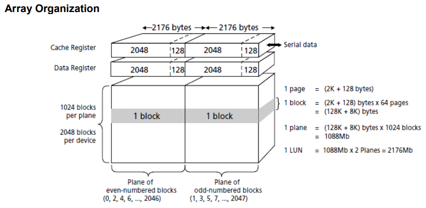

Does AM6234 support 2 planes array QSPI NAND?
The boot mode setting is following,
  • Bit[2:0]= 011 for Ref CLK = 25MHz
  • Bit[6:3]/[9:7]= 0000/111 for Serial NAND mode/ SPI  1-1-1 Mode
  • Bit[12:10]/[13]= 000/0 for none
  • Bit[15:14]= 00 for reserved pins
We use 1 plane NAND (W25N02KVZEIR) and boot successful, but 2 planes NAND (F50L2G41XA-104YIG2B) is boot fail.
https://www.esmt.com.tw/upload/pdf/ESMT/datasheets/F50L2G41XA(2B).pdf
ESMT NAND: F50L2G41XA-104YIG2B

    According to the advisory i2372 of the AM62x Processor Silicon Revision 1.0,1.1 Errata there are certain restrictions for the AM623 ROM loader to boot from multi-plain serial NAND flash memories.
    There is also a hint in the Section, Serial NAND Boot / Section, Serial NAND Bootloader Operation of the AM62x TRM
    The documentation of the F50L2G41XA-104YIG2B shows that there is a Plane Select bit that shall be present in Read from Cache- command used by the AM623 ROM loader  during Serial NAND boot mode in 1S-1S-1S configuration (0xB).
    It seems that the presence of a "Plane Select bit" in Read-cache command of the F50L2G41XA-104YIG2B  contradicts with the requirement by ROM Code. In order for ROM to boot successfully from multi-plane memory there shall be NO such bit.

    I got confirmation from the AM62x ROM expert that the AM6234 (i.e. AM62x Silicon Revision 1.0) ROM does NOT support boot from the Dual Plane SPI-NAND F50L2G41XA-104YIG2B.
