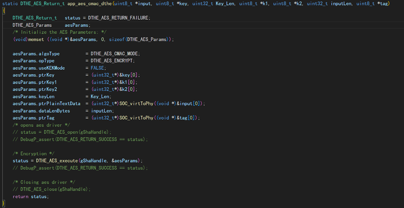

To implement the CMAC streaming mode functionality, it is necessary to add this feature to the HSM firmware. However, TI does not officially provide this function or a demo running on the HSM side. Therefore, the crypto_aes_stream example from the SDK was adopted (mcu_plus_sdk_am263px_11_00_00_19\examples\security\crypto\dthe_aes\crypto_aes_stream).
This function has been successfully ported to the R5 core and runs correctly. However, when I ported the corresponding program to the M4 core, it failed to operate normally. I have already passed the relevant information such as the original text and CMAC key to the M4 core via SIPC in the form of a service request. Meanwhile, in single‑step mode, the M4 core can run properly (referring to the example: tifs_am263px_11_00_00_01\examples\dthe\aes\crypto_aes_cmac_128).
My question is: What modifications are required to successfully port the CMAC streaming mode program—which works on the R5 core—to the M4 core? Especially regarding the following programs, which are the ones I modified to run on the M4 core but are currently experiencing abnormal operation.
static int32_t app_aes_cmac_dthe_stream_start(uint8_t *Key, uint32_t Key_Len, uint8_t *K1, uint8_t *K2)
    DTHE_AES_Return_t   status = DTHE_AES_RETURN_FAILURE;
    DTHE_AES_Params     aesParams;
    /* Initialize the AES Parameters: */
    (void)memset ((void *)&aesParams, 0, sizeof(DTHE_AES_Params));
    /* Initialize the encryption parameters: */
    aesParams.algoType          = DTHE_AES_CMAC_MODE;
    aesParams.opType            = DTHE_AES_ENCRYPT;
    aesParams.useKEKMode        = FALSE;
    aesParams.ptrKey            = (uint32_t*)&Key[0];
    aesParams.ptrKey1           = (uint32_t*)&K1[0];
    aesParams.ptrKey2           = (uint32_t*)&K2[0];
    aesParams.keyLen            = Key_Len;
    aesParams.ptrPlainTextData  = (uint32_t*)NULL;
    aesParams.dataLenBytes      = 0U;
    aesParams.ptrTag            = (uint32_t*)NULL;
    aesParams.streamState       = DTHE_AES_STREAM_INIT;
    aesParams.streamSize        = 0U;
    /* Start Call */
    status = DTHE_AES_execute(gShaHandle, &aesParams);
    // DebugP_assert(DTHE_AES_RETURN_SUCCESS == status);
    return (status);

Thank you for your responses, experts
    Great that the application you have is working on R5 Core.
    Would like to know your current status
    1. Is the device HS_FS or HS-SE?
    2. If HS-SE, have you created a service on the HSM TIFS side for CMAC (or reusing any service)
    3. If yes, are you send the original text and CMAC key using this service? or just using the SIPC as standalone?
    4. If using service, could you unlock JTAG on M4 (if HS-SE device)  and check where is M4 core hanging or crashed?
    Thanks and Regards,
    Nikhil Dasan

    static DTHE_AES_Return_t app_aes_cmac_dthe(uint8_t *input, uint8_t *key, uint32_t Key_Len, uint8_t *k1, uint8_t *k2, uint32_t inputLen, uint8_t *tag)
        aesParams.ptrKey            = (uint32_t*)&key[0];
        aesParams.ptrKey1           = (uint32_t*)&k1[0];
        aesParams.ptrKey2           = (uint32_t*)&k2[0];
        aesParams.ptrPlainTextData  = (uint32_t*)SOC_virtToPhy((void *)&input[0]);
        aesParams.dataLenBytes      = inputLen;
        aesParams.ptrTag            = (uint32_t*)SOC_virtToPhy((void *)&tag[0]);
        /* opens aes driver */
        // status = DTHE_AES_open(gShaHandle);
        /* Encryption */
        /* Closing aes driver */
        // DTHE_AES_close(gShaHandle);
        return status;
    app_aes_cmac_dthe_stream_start、app_aes_cmac_dthe_stream_update、app_aes_cmac_dthe_stream_finish These functions have already been sent before.

  • I'm not entirely clear about your meaning. Steps 2-5 form a complete process. It's only at step 5 that we can see whether the CMAC is correct. What I can confirm now is that the status returned from steps 2-5 is correct, and the CMAC algorithm on the M4 side is running normally. However, the CMAC result is just incorrect. Yet, this exact logic runs correctly on R5. The process starts with AES_STREAM_MODE_START, then loads data twice via two calls to AES_STREAM_MODE_UPDATE, and finally completes the calculation by loading the remaining data through the finish operation.
  • Upon initial analysis,
    I see that one difference between R5 and M4 code is that for R5 code as shown below
    R5F
    aesParams.ptrPlainTextData  = (uint32_t*)&gCmac_unprocessed_block[0U];
    M4
    aesParams.ptrPlainTextData  = (uint32_t*)SOC_virtToPhy((void *)&gCmac_unprocessed_block[0U]);
    Can you add SOC_virtToPhy in all aesParams.ptrPlainTextData in update and finish APIs and also in app_aes_ecb plain and encrypted text as shown above?
