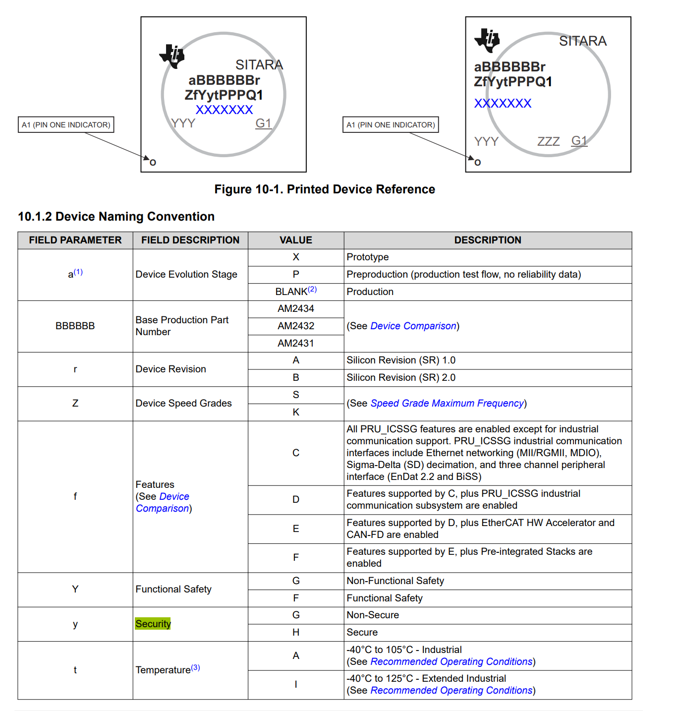

We have at least two TMDS243EVM PROC101C(005). Both have a Sitara with the printing:
XAM2434B
SFGHIALV
according to the data sheet this should a be a secure processor:

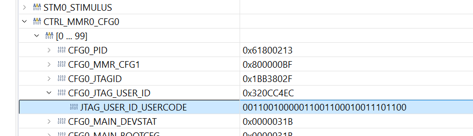

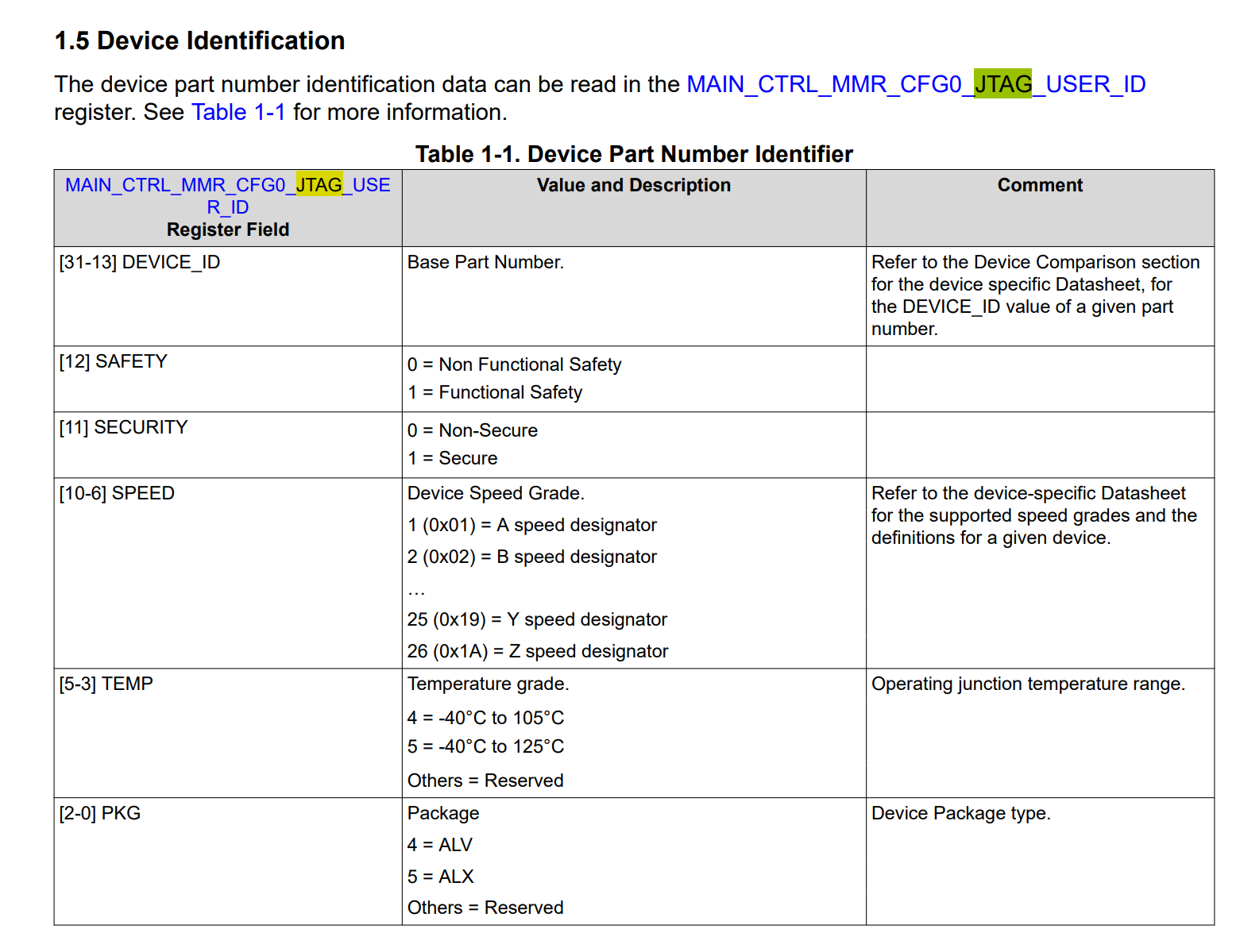

But if we read our the JTAG_UDER_ID-register which should give info ybout the SoC in firmware, we see it's not set as a secure Sitara:
if we check the bits:
JTAG_USER_ID_USERCODE    00110010000011001100010011101100
we have:
PKG: 100: 4 ALV (correct)
TEMP: 101: -40-125°C
SPEED: 10011: 23
SECURITY: 0 (Non-Secure!)
SAFETY: 0 (no safety, ok!)

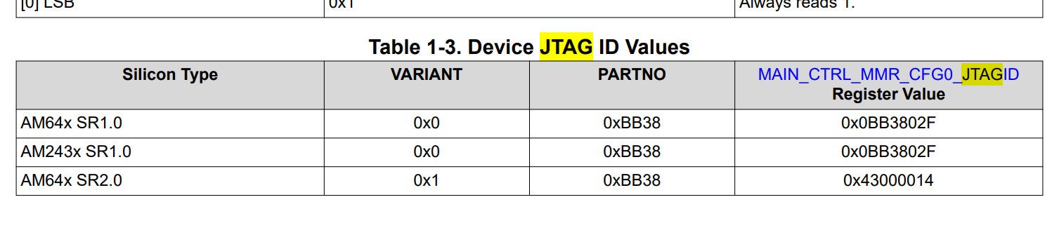

the JTAG-deviceid is also not the one of the listed possibilitites in the tram:
or the list is not complete... (TRM Rev H).

    If your use case is identifying the device type, it is better to read the device type from the SECMGR MMR. The SECURITY bit in the JTAG ID register can differentiate between the GP and HS device but cannot differentiate between the HSFS and HSSE device.

    The register information is not available in the TRM. It is part of the SECMGR MMRs which are available in the Security TRM. You would need to request access to the secure resources.
