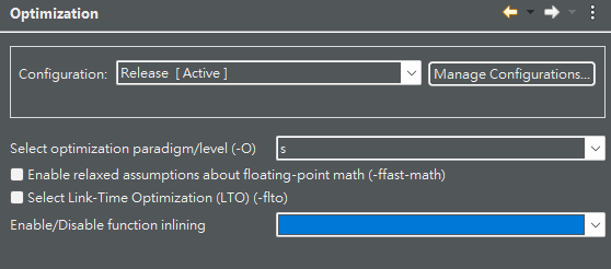

To improve the R5F & PRU execution efficiency.
Regarding the compiler selection and optimization settings for the R5F and PRU cores, are there any better configuration recommendations?
Our current configuration is as follows:

  • R5F-Optimization Setting
  • PRU-Optimization Setting

  • Hi Bolt,
    The above optimization looks okay. For maximum performance optimization you can use the -O3 flag is recommended and for size optimization -Oz is recommended.
    For both performance and size optimization, use -Os flag.
    If there are other relevant settings not listed above that can further improve execution efficiency, we would greatly appreciate any additional configuration
    Please refer tiarmclang-optimization-options to get more details on TI ARM CLANG optimizations.
    Please refer section 3.1 Invoking Optimization of spruhv7c.pdf for more details on PRU optimization.
    The --opt_for_speed=5 used above will optimize the performance/speed by having high risk of worsening or impacting code size.
