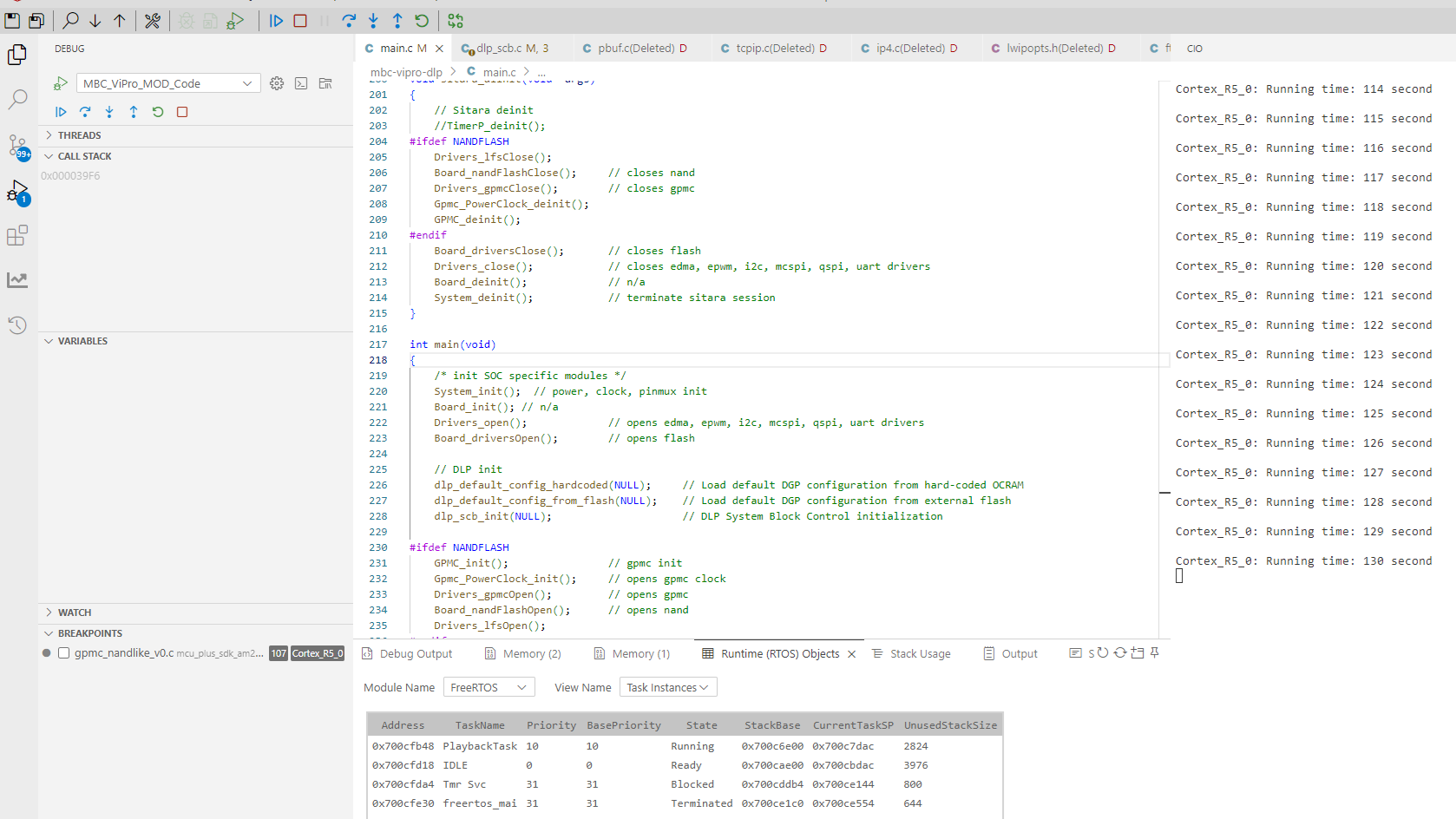

The procedure is blocked in CCS debug session after 2 or 3 minutes.
There is no call stack infomation after I click Pause button. You can see below picture for more detail.
Do you know the possible reason?

Issue debugged: Caused due to HSM WDT reset from incorrect bootmode. Not seen in DevBoot mode.
