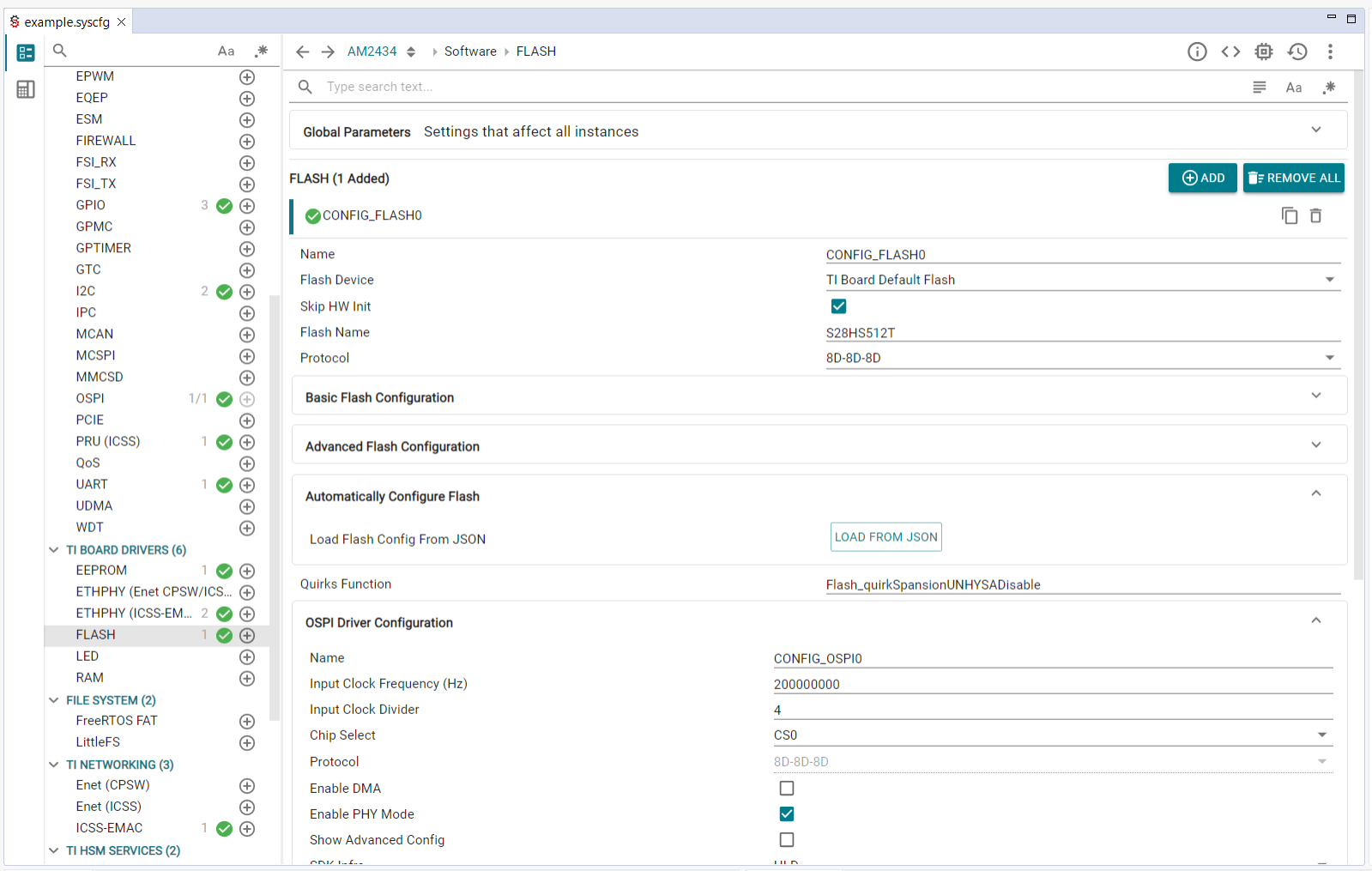

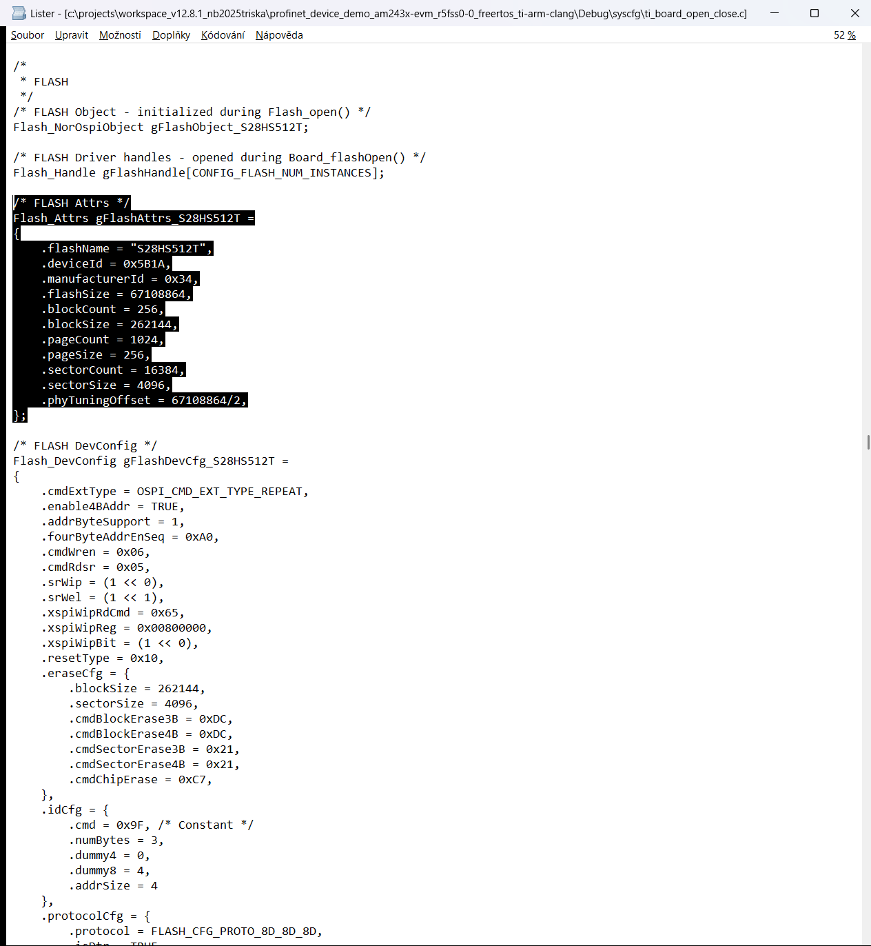

I have noticed that TI UniFlash (similar to the OSPI bootloader) stores and works with certain information in the flash memory during application flashing, specifically the PHY tuning data (--operation=flash-phy-tuning-data). The offset for storing these data is currently set to the middle of the flash memory, as defined in the structure generated by TI SysConfig Tool in the Profinet demo project.
TI SysConfig Tool automatically defines and regenerates all these global structures based on its configuration. However, for application-specific reasons, I need to relocate the position where PHY tuning data are stored. Unfortunately, I cannot find any option in TI SysConfig Tool to change this.
Could you please advise how to modify the .phyTuningOffset value in the generated structure using TI SysConfig Tool? Is there a supported way to configure this offset?
