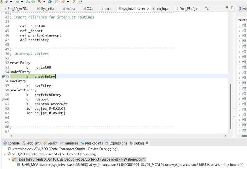

Trying to push firmware data from host(TMS570LS0914) to PLC chip (QCA7006) via SPI1. After excution of some commands it is going to undefEntry.
The LR is consistently pointing to this __TI_Decompress_None when the undefEntry is reached.
This issue is impacting the project flow, and resolving it will help us proceed to the firmware download activity for the PLC chip.

    However, we have one internal AI which can analyze old data e2e database and all the documents related to this controller. When i feed this issue i got below useful information and solutions. Please verify them and use it once.
    The problem you're experiencing with the LR pointing to __TI_Decompress_None and jumping to undefEntry is related to BFI.W (Bit Field Insert) instruction incompatibility.
    Root Cause
    The BFI.W instruction is a Thumb-2 instruction that is NOT supported by the Cortex-R4F core in the TMS570LS0914. This instruction is only available in:
    • Cortex-R5F and later cores
    • Cortex-M3/M4 cores with Thumb-2 extensions
    When the processor encounters the BFI.W instruction, it triggers an undefined instruction exception, causing execution to jump to undefEntry
