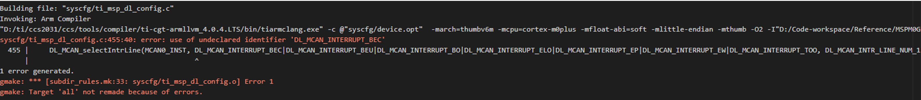

MSPM0G3519: MCAN interrupt Bit Error Corrected interrupt in Sysconfig
Part Number: MSPM0G3519
Hi champs,
I am asking this for our customer.
SDK: mspm0_sdk_2_07_00_05
CCS: 20.3.1.5

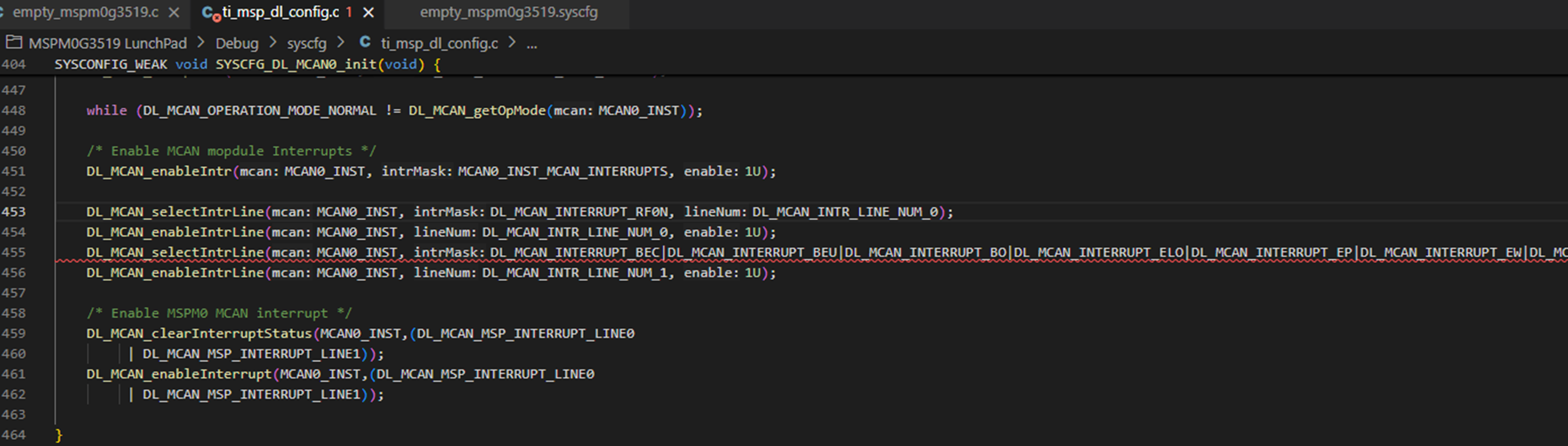

When the user uses Sysconfig and chooses "Bit Error Corrected interrupt" below, there will be generated codes below, which causes code building errors.
Do you see this on your side?
If yes, how do you solve it?
Code generated...
