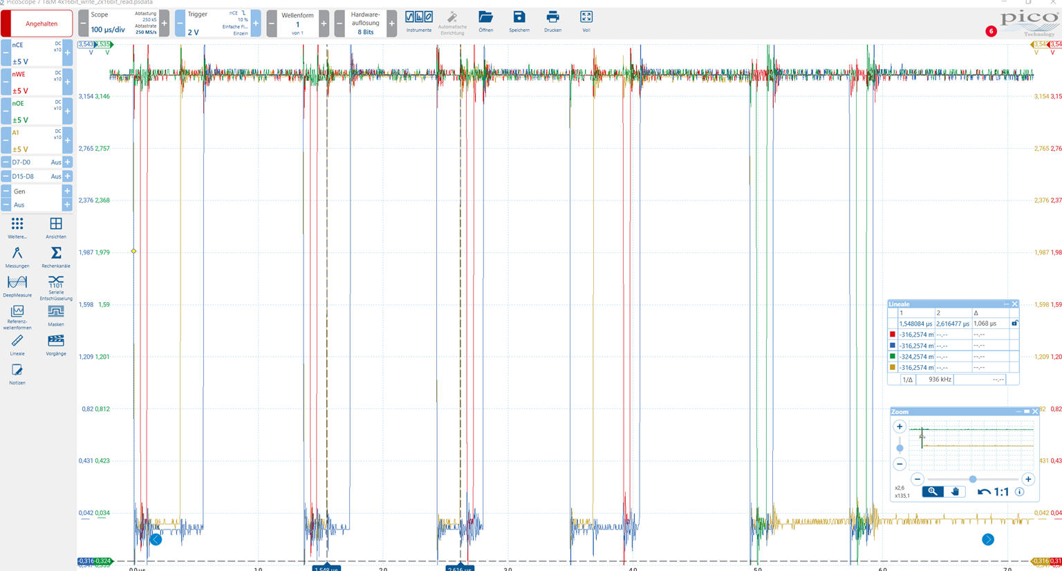

-We have also carried out tests with the EMIF interface, which have led to further questions.
The interface was operated at 37.5 MHz and the associated configuration register (CE2CFG) was set to the value 0x04142111U.

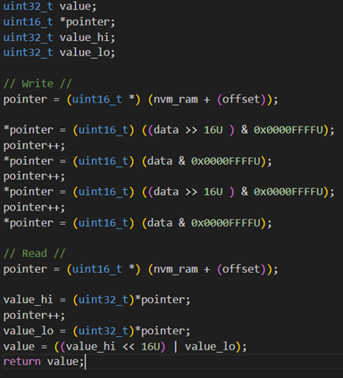

The following recording shows four 16-bit write accesses followed by two 16-bit read accesses:
The following code was executed for this:
The two read accesses look as expected, but the four write accesses do not.
It is noticeable that the chip select is pulled much earlier or remains pulled much longer than necessary.
The address bit A1 also does not always behave as described in the TRM.
Furthermore, the extremely long time between individual accesses is noticeable, varying between 613 ns and 1.068 µS (see rulers).

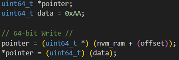

Another test was carried out, this time with a 64-bit write access:
As expected for a 32-bit architecture, this access was divided into two 32-bit accesses.
Each 32-bit access appears to consist of two 16-bit accesses directly strung together.
However, this test again shows a very long time (1.198 µS) between the two 32-bit accesses.

  • -How can the behaviour of the chip select during write accesses be explained, and can this be reconciled with the information from the TRM?
    -Is there a way to shorten the long wait time between individual 16/32-bit accesses in order to achieve a higher effective data rate?
    For 16-bit data write, there is only one WE pulse in on CS period since only 1 bus transaction. For 32-bit data write, there are two WE pulses in one CS period because of of two bus transaction.
    EMIF asynchronous interface can operate in either normal mode or select strobe mode. In normal mode the nCS will be active for the entire EMIF transaction. In select strobe mode the nCS is only active during the strobe time.
    In normal mode, the nCS is active for an entire EMIF bus transaction. For example, if you are writing to a EMIF address, the nCS is active for the entire bus transaction (16-bit write) while the nWE has two or three pulses while the nCS is active. This is the bug in revA silicon. However, in select strobe mode, the nCS is only active during the strobe phase which means that the nCS is actually active in phase with the nWE. While we see extra nWE pulses in normal mode we would also see extra nCS in select strobe mode.
    This bug has been fixed in revB and later rev silicon. The extra nWE pulses has been removed during write transactions. However, there was some technical difficulty to shorten the extra duration of the active nCS in addition to removing the extra WE pulses. When switched to select strobe mode, these extra duration of nCS remains as two extra nCS pulses. But the nWE and nOE are not active when these extra nCS pulses are active. So from a memory access stand point this should be fine. All writes and reads to the memory should be qualified with the valid nWE and nOE.
    For read, not only were we able to remove the extra nOE pulses but also to shorten the nCS as well to improve EMIF performance/bandwidth. Therefore, during read, there is no extra nOE or nCS pulses seen in either normal or select strobe mode.
    This extra CS duration will lower the throughput, but will not cause the data lost.

  • Hi Johannes,
    The length of one CS can be calculated using the parameters (setup, strobe, hold) written in CE2CFG: (2+2+3)*EMIF clock cycles
    Three CS cycles is around 600ns.
