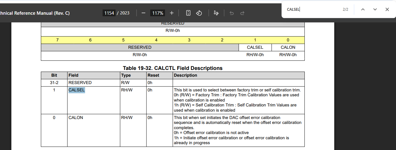

Hi Team,
My customer found if call DL_DAC12_startCalibration, the DAC performace get better. Even if they don't read and use CALDATA.
But from this E2E, they should use CALDATA after DAC Calibration. We don't know why DAC performace get better.
__STATIC_INLINE void DL_DAC12_startCalibration(DAC12_Regs *dac12)
    dac12->CALCTL =
        (DAC12_CALCTL_CALON_ACTIVE | DAC12_CALCTL_CALSEL_SELFCALIBRATIONTRIM);
  1. Could you help explain CALSEL bit function? TRM don't explain how to use this bit.
  2. what the relationship of CALSEL and CALON bit? There is some infomation about CALON , and tell user how to do offset calibration in TRM 19.2.11 DAC Output Amplifier Offset Calibration. But in our driverlib, why we set DAC12_CALCTL_CALSEL_SELFCALIBRATIONTRIM?
  • Hi Zane,
    Enabling the CALON bit allows the user to calibrate any offset errors to achieve the best performance of the DAC.
    CALSEL bit let the user chooses whether to use the factory trimmed value which is one time adjustment during final test or using the Self Calibration during customer user case to Calibrate the best trim value. It is default to Factory trim but using the Self Calibration Trim will have better results.
    In order to achieve the best results, we want to enable CALON bit to initiate the offset error calibration and enable CALSEL bit to self calibration trim to calibrate to the optimal trim to compensate the offset errors. Therefore in the Driverlib we setting the DAC12_CALCTL_CALSEL_SELFCALIBRATIONTRIM.
    Bill
  • Hi Bill,
    I do some tests on M0G1507-LP, and import dac12_fixed_voltage_vref_internal_LP_MSPM0G3507_nortos_ticlang demo, use multimeter to measure PA15 and GND.

  • Hi Zane,
    I made some adjustment on the code you provided above.
    For DL_DAC12_performSelfCalibrationBlocking(DAC0) and DL_DAC12_getCalibrationData(DAC0) function to work correctly you will need to enable it after the DAC module is enabled which is after the DL_DAC12_enable(DAC0).

    Without the calibration and with voltage Output 1000 mV PA15  measured: 1.012 V
    With calibration: PA15 Voltage is 1.008 V
    Without the calibration and with voltage Output 2000 mV PA15 measured: 2.010V
    With calibration: PA15 Voltage is: 2.006 V
    I hope this helps.
