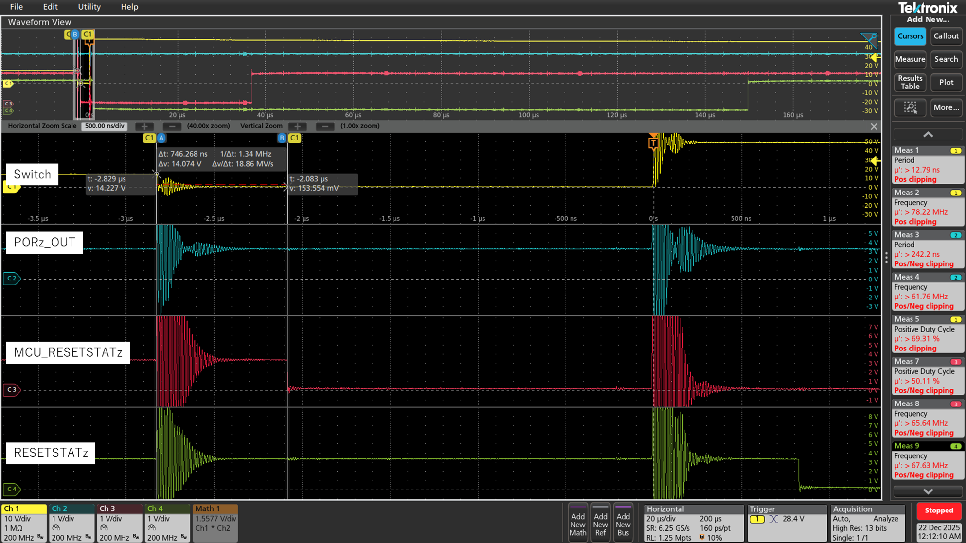

I am investigating the internal reset circuitry of the AM2434 because I am experiencing unexpected resets when operating an external switching circuit. The device behaves as if it has been reset during this operation.
According to the datasheet (Figure 6-5), RST3 (Power-On Reset) requires an off time of 1200 ns. However, I would like to know if there are other conditions that could cause MCU_RESETSTATz or RESETSTATz to assert.
Observations:
  • I monitored PORz_OUT, MCU_RESETSTATz, and RESETSTATz on the board while the switching circuit was active.
  • All signals showed noise-like waveforms during switching.
  • PORz_OUT only had about 200 ns of noise, but MCU_RESETSTATz and RESETSTATz went low for the same duration as a normal reset pulse and then returned high.
  • After this event, when checking the CTRLMMR_RST_SRC register in CCS, bit 20 and bit 0 were set.

  • Regarding Reset Source bits descriptions, please see snapshots from the TRM:
    The application is a motor drive, and I suspect that surges are caused by switching the gate signal. However, my question is specifically about the AM2434 specifications.
    Under what conditions does RESETSTAT go low or a RESET occur after power-up on the AM2434? For example, when there is a surge, we observe signals that suggest the clock is fluctuating. What happens if the PLL loses lock? Also, if MCU_PORz goes low for a few nanoseconds, will that trigger a reset? In Figure 6-6 of the datasheet, the low time for MCU_PORz is not specified, and the specification (RST4) states that the minimum time for RESETSTATz to go low is 0 ns. Does this mean that even a momentary low can cause a reset?
    I have also referred to the TRM, but the description provided did not allow me to fully understand the details. After a normal power-on, when I checked the same register from CCS, only bit 20 was set. I have not used any gen scripts during JTAG connection, and I have not applied any JTAG reset. I expected bit 12 (COLD_OUT_RST) in this case.
    Finally, after power-up, when I wrote 4'b0110 to CTRLMMR_RST_CTRL.SW_MAIN_WARMRST from CCS and then checked the CTRLMMR_RST_SRC register, I expected only bit 21 to be set, but bit 20 was also set. Furthermore, after repeating the same procedure several times, bit 0 was sometimes set as well, so I cannot clearly understand the behavior of this register.

    • MCU_PORz HW Pin       -> PORz_OUT pin
    • MCU_RESETz HW Pin   -> bit 0 of CTRLMMR_RST_SRC register
    • RESETz_REQ HW Pin   -> bit 2 of CTRLMMR_RST_SRC register
    6. Yes, PRUSS can be reset-isolated from main domain warm resets. More specifically here, from pin resets on MCU_RESETz and RESETz_REQ.
    Generally, please note that the induced noise on your scope screenshot is with amplitude exceeding several times the maximum allowed in datasheet. This is  enough to observe unwanted behavior or even damage the SoC. Do you have an appropriate snubber/supressor circuitry on motor connectors to suppress switching noise?
