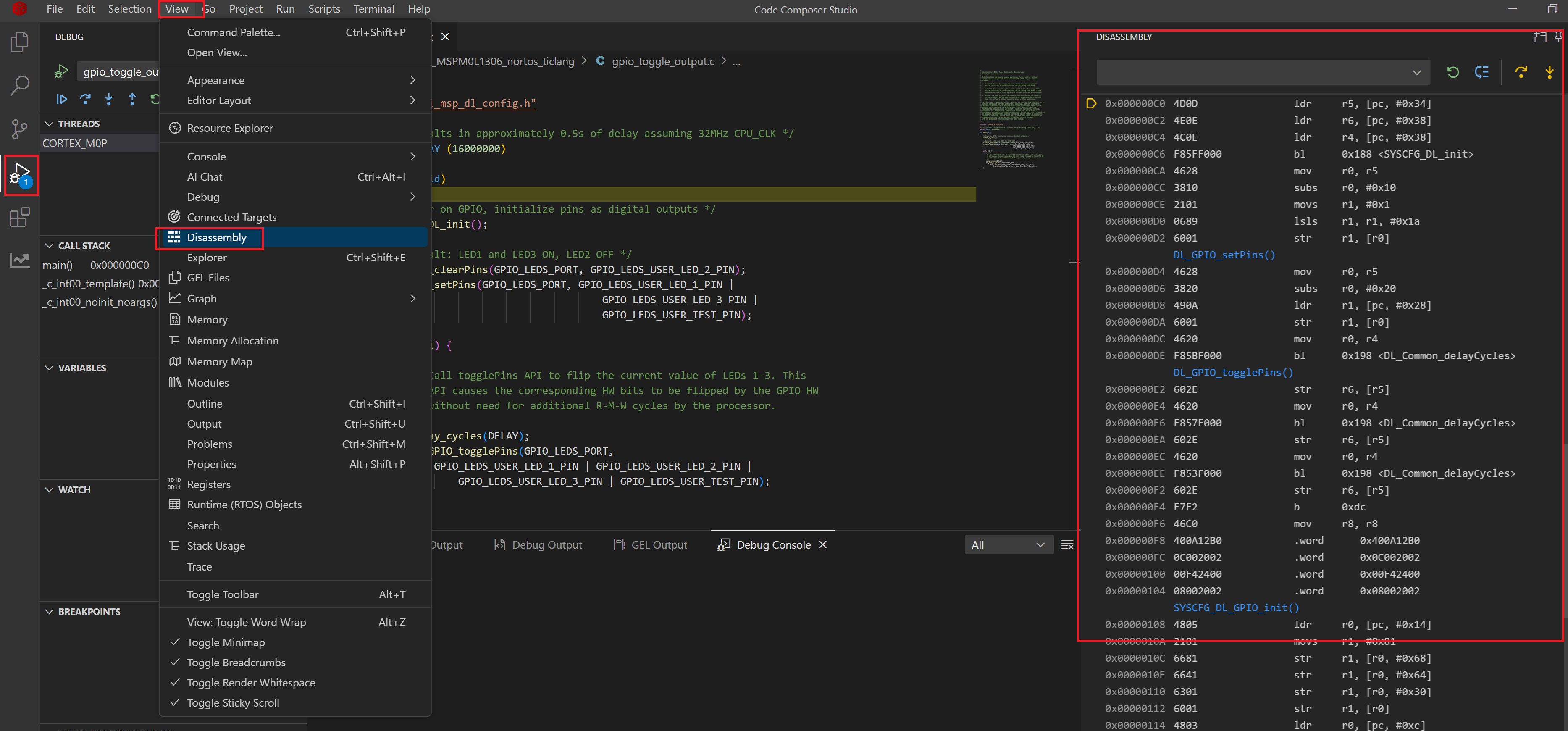

Hi champs,
I am asking this for our customer.
For MSPM0 devices,
The user is aware how to show disassembly when conneting to an MSPM0 target board below.
But is it possible to generate .asm files based on the source offline without XDS110-connecting to the target board?
If yes, would you please show us how to do that?
PS. use TI Clang V4.04 + CCS 20.4
    Yes. Enable the below compiler option:
    The generated assembly (*.s) files will be kept in the build configuration subfolder (where the generated executable (*.out) also resides)/
