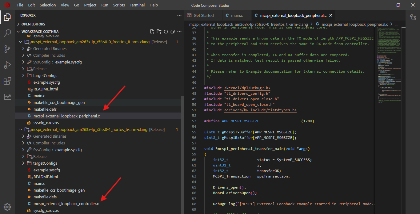

i saw to have both examples run the controller.c and peripheral.c to see the external loopback happen but im not able to debug both programs at the same time. i'd like to know if there is a way to do it, or am i having the concept wrong?

    could u be more specific to how ill be able to write one code say controller.c in one core and the slave the peripheral.c in another core and debug it at the same time. its not about the code im having issue , i havent used this setup such that im not able to see where ill write these codes separately for different cores. Could u be more specific to this

    So the requirement is that one core will have controller.c file and another core will have the peripheral.c file. Say core 0-0 has peripheral.c and core 0-1 has the controller.c code as given in the initial screenshot. Once the project is set, we can build the system project. Building the system project means both the projects core0-0 and core0-1 will also be built automatically. Once thats is done, we will have the out file for both the project.
    Now to debug them, start the target confoguration. When the target configuration is launced we can see all the core like below,
    Now select both the cores, core 0-0 and core0-1 and right click and click on group cores option as below
    Now connect to core 0-0 and load the program
    Do the same for core 0-1.
    Now you can see both the cores at the main() function.
    Aswin
