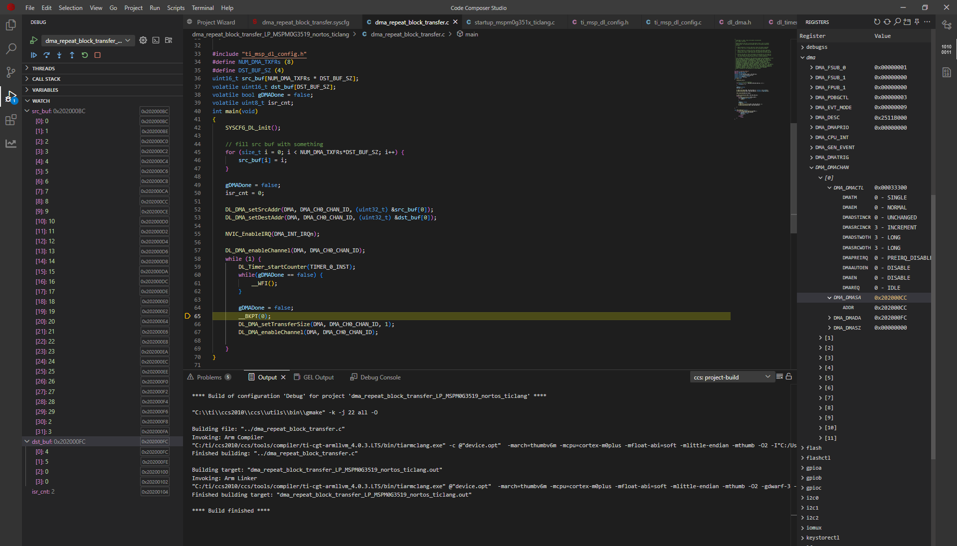

I'm trying to configure the DMA to eventually do a block transfer to a single fixed address with repeat single transfer of length long.
I'm using timer to trigger the DMA and right now I basically have this set to do 1 transfer at a time so I can see what's happening step by step.
 Basically it looks like the DMA transfer is clobbering the upper region of the src_buf array since the underlying type is uint16:
Is there a requirement for when the DMASRCWDTH is long that these values are aligned to 32 bit word boundaries?
That seems to be what this looks like, but I don't see anything in the documentation that makes this a requirement.
