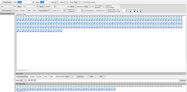

Observed Behavior (Corruption on first reception)
  • On first transmission, bytes sampled in the UART RX data buffer do not match what was sent.
Example 1
  • Host sent: 0xA5
  • DSO shows serial bits: 0101001010 (start/LSB‑first representation from HTerm)
  • Device RX buffer reads: 0x5A (and sometimes 0x2D)
    • 0x5A = 0101 1010 (appears like bit‑reverse of 0xA5 = 1010 0101)
Example 2
  • Host sent: 0x22
  • DSO shows: 0010001000
  • Device RX buffer reads: 0xEE (sometimes 0x37 or 0x6E)
    • 0xEE = 1110 1110 (not the transmitted pattern)
  • After resending the same command 2–3 times, device starts responding and subsequent traffic is often correct.

    Dose the device can receive the string correctly? Do you have a logic analyzer like Saleae to capture the wave forms that will be better.
    How about if you enabled the TX pin at start up?
  • Dose the device can receive the string correctly? ---> yes, it receives data correctly but not in first go - we need to send same command 2-3 times, and then we receive response
    How about if you enabled the TX pin at start up? ---> we are using be default that pin for other purpose so on startup we cannot enable TX. Issue is not only for 1st command even after enabling TX for all the commands response is not coming immediately in first try, we need to send same command 2-3 times.
