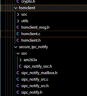

  1. We download the SDK "mcu_plus_sdk_am62px_11_02_00_23", but don't found any security driver or HSM (TIFS) APIs, compared with "mcu_plus_sdk_am263x_11_01_00_19" , it has HsmClient and SIPC package, why in am62px SDK, don't have it? I got info, in "3.4.1. Device Security — Processor SDK AM62Px Documentation" link, will have description, yes, it has, but where have the package? below image show the am263x SDK:

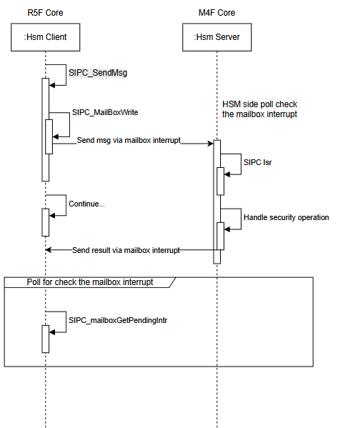

  6. As we know, in AM263x CPU, the Security operation will be handled by HSM core, the R5F or A53 cores will only request it to HSM core, is it same with AM62Px? if yes, does below sequence correct?

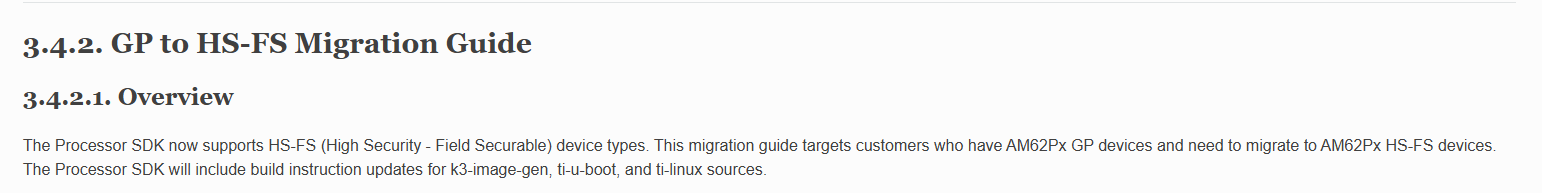

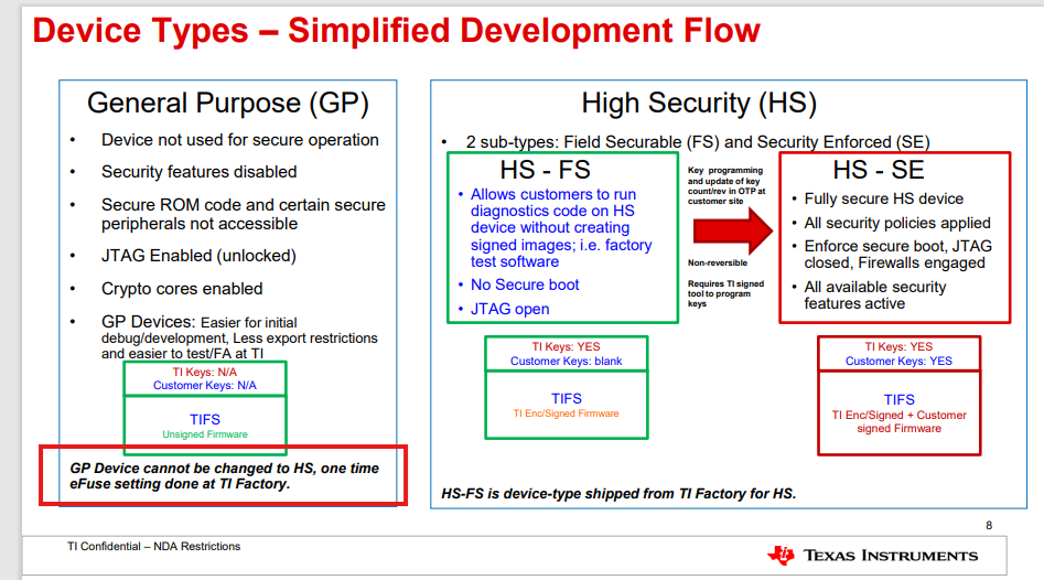

  7. For Device type, I got info: "GP device cannot switch to HS", but in link "3.4.1. Device Security — Processor SDK AM62Px Documentation ", it mentioned can mogration GP to HS-FS, please help to clarify:

    AM263 and AM62P have different security architectures. We have the TIFS firmware on AM62P which runs on the M4F0 core in the SMS. This TIFS firmware is provided as binary only in the SDKs and acts as a server listening for TISCI requests from the other cores in the device. The TIFS documentation is available here:
    https://software-dl.ti.com/tisci/esd/latest/index.html
    There is another core called HSM core in the SMS dedicated for running customer's HSM stack. The TIFS core always runs independent of the HSM.
    All the images are authenticated with the same key only (active key in the efuse).
    The migration is from the software perspective only. Like, if one was working with GP devices and now have HS devices, the migration guide discusses how to migrate the software to the HS devices.
