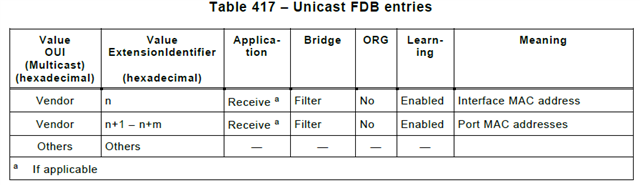

  • Hello Kamil,
    I have another question. Is the behavior of +1 and +2 inherited from the Profinet specifications, or is it a design choice made by the Profinet stack? Would it be possible, hypothetically, to request a custom Profinet Stack that implements a different method for obtaining the MAC addresses of the ports?
    Thank you,
    Andrea
  • Hello Andrea,
    From the specifications, I could find that the bridge Filtering Database (which also applies to the end-station) assigns port MAC addresses are sequential values of the interface MAC address:
    Would you please explain why aren't you able to assign sequential MAC addresses? in general, this approach is recommended by Profinet community and it is widely adopted. If you are interested in a custom solution and would like us to do an initial evaluation of viability and efforts of implementing this, please reach out to your regional sales representatives.
