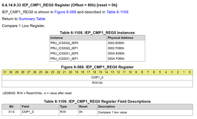

  • Thanks, can you share a download link for the complete register map? I also need time stamp for sync0

  • Hi Jianyu,
    You can find the TI ESC Register Map here: TI EtherCAT SubDevice Controller Register List. TI Vendor specific registers can be found under "TI ESC Vendor Specific Registers" section.
    The Sync0 timestamp is not brought out to the ESC Register. One option is that you can monitor IEP_CMP1_REG0 Register (offset 0x80-0x87) which will have time when the next Sync0 signal will be triggered:
    The Sync signal is triggered when the IEP counter hits the value programmed in the above register. Once the signal is triggered, the above register is re-programmed with the the next time (based on the cycle time) when the signal is to be triggered.
    Another question, is the time stamp based on IEP0? Is this clock be modified by ARMW command used to synchronize all clocks?
    Yes, correct.
