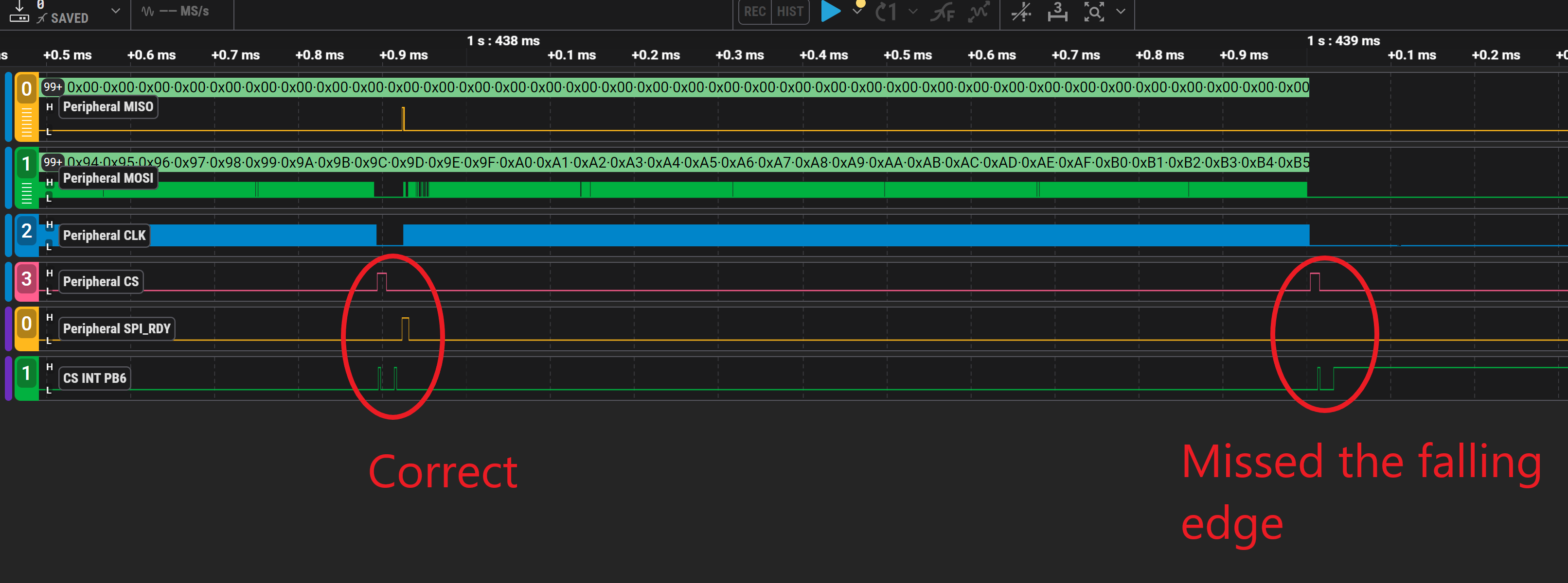

I have a GPIO input (PB7) on my LP-MSPM0G3507 development board that I'm using as a manually controlled chip select input for a SPI bus. I've configured PB7 to interrupt on both rising (deselected) and falling (selected) edges. This works almost all of the time, but I keep running into a scenario where the falling edge interrupt fires when I read DL_Interrupt_getPendingGroup(DL_INTERRUPT_GROUP_1) in the Group1 ISR I correctly get DL_INTERRUPT_GROUP1_IIDX_GPIOB. Then when I read DL_GPIO_getPendingInterrupt(GPIOB) to get the pin that generated the interrupt I sometimes read GPIO_CPU_INT_IIDX_STAT_NO_INTR. However, capturing the signal, the GROUP1 PortB interrupt is correctly firing, but indicating NO_INTR instead of GPIO_CPU_INT_IIDX_STAT_DIO7?
In this capture, you can see the first circled CS_INT trace pulse twice for the two CS edges. In the next circled CS_INT trace, the CS_INT trace pulses twice too, but the second is being reported as NO_INT by DL_GPIO_getPendingInterrupt(GPIOB). CS_INT is set on Group1 ISR entry and cleared on Group1 ISR exit and the CS pulses are ~10uS. This behavior is inconsistently happening, but always happens eventually.
Here's my Group1 interrupt handler:

  • pinIndex = DL_GPIO_getPendingInterrupt(GPIOB);
    DL_GPIO_clearInterruptStatus(GPIOB, pin);
    getPendingInterrupt() reads the IIDX register, which clears the RIS bit for the relevant interrupt. clearInterruptStatus() explicitly clears the RIS bit (already cleared), which sets up a race where it could clear the Next interrupt instead.
    I recommend you remove the DL_GPIO_clearInterruptStatus() call(s).
  • That was it. Thank you, Bruce!
