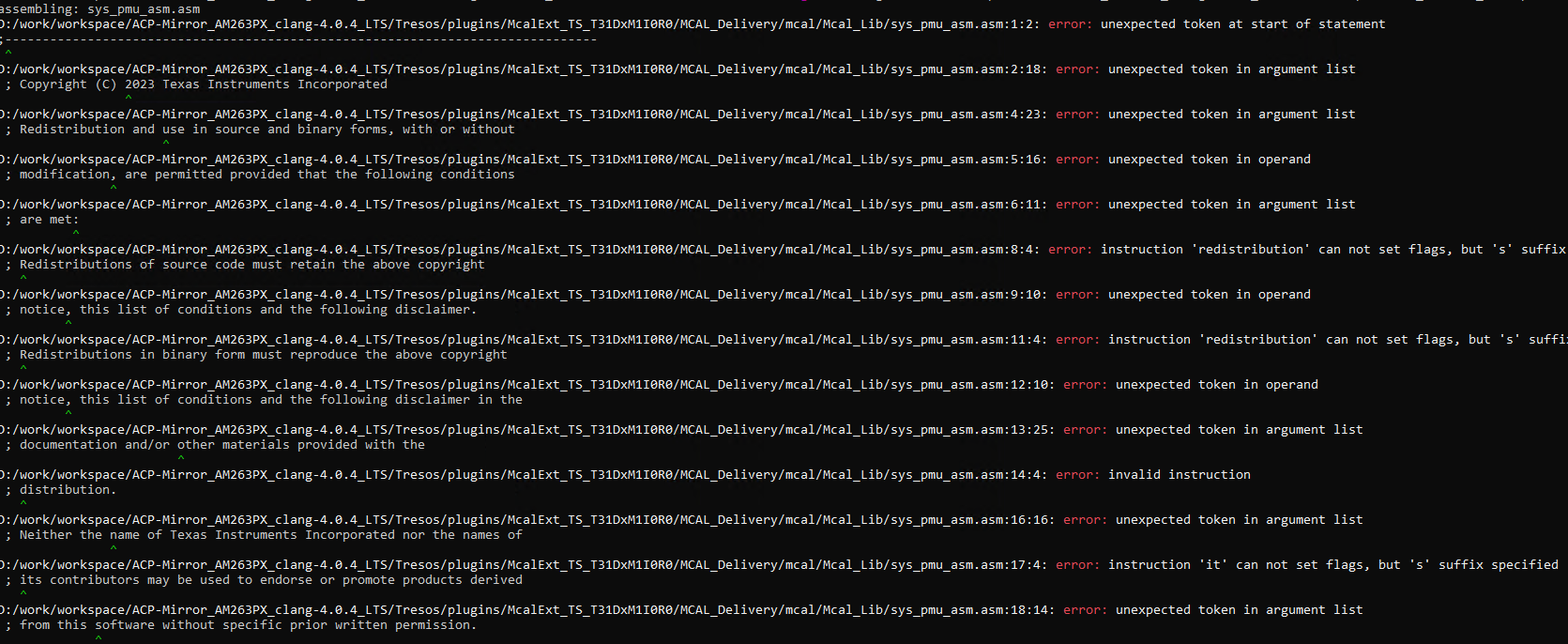

Currently we are working on MCAL_AM263Px_11_01_00_11,
Below Code Compilation error is reported while integrating MCU Module from mentioned MCAL package:
We are using TI ARM-CLANG-4.0.4_LTS and assembler doesn't recognize or support ";" for comments. After replacing ";" with "@" or "//" Compilation looks ok.
Could you please provide your feedback on this?
