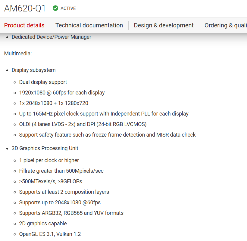

Hi team,
I would like to confirm whether AM620-Q1 has GPU or not for vision processing and whether it can support dual display output or not.
This is for e-mirror application and customer is trying to find a chip that has AI processing and 2xDPI for 2 display more than full HD resolution. Another interface beside DPI is acceptable too.
I looked at ti.com for AM620-Q1 and seems like there is GPU but after checking the datasheet, for am620-Q1 it is written no GPU. Could you help me confirm ?
Can it also support dual display ?
