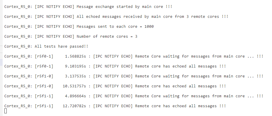

I had successfully debuged the ipc_notify_echo_am263x-lp_system_freertos_nortos demo with luanchpad.image.png
But There is error when I debug this demo with our own board with XDS110. You can see below picture.
    Could you confirm the part number of the device on your board?

  • The part number is AM2632 on your board. Does it mean we can only use two core?
    Yes, that is correct. And you would be able to use R50-0 and R51-0 in that case. R50-1 and R51-1 would not be available.
