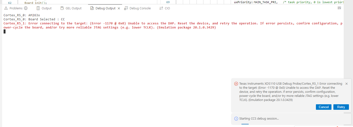

I had successfully debuged the ipc_notify_echo_am263x-lp_system_freertos_nortos demo with luanchpad.
But There is error when I debug this demo with our own board with XDS110. You can see below picture.

Are you working on a Linux system? I recently encountered a similar issue where the XDS110 was detected correctly (confirmed via kernel logs and `lsusb`), but CCS was unable to establish a connection.
The root cause was related to udev rules—the USB device permissions were configured for the root user, while CCS was running under a standard user account. Updating the udev rules to grant appropriate permissions to the current user resolved the issue.
I recommend verifying your udev configuration to ensure proper device ownership and permissions.
