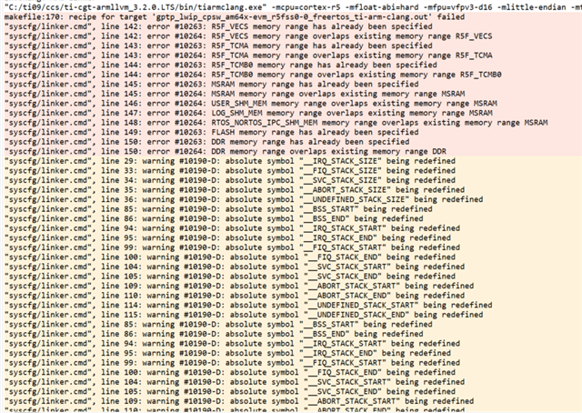

      Thank you for your reply. I discovered the enet_layer2_multi_channel project in the SDK 9.2 development package. Is this a 1588 example? How is this example related to the ones you mentioned? I'm a beginner in this area and hope you can help me differentiate and understand. After running enet_layer2_multi_channel on the board, I encountered errors as shown below. According to my usage scenario, which one do you think is the most suitable? Another question: my Linux environment's network card does not support hardware timestamping. Are there other methods to implement it? For example, using a software timestamping approach. The first step for me is to understand the entire time synchronization process; precision is not the main concern for now.
  • I have also discovered an issue: on the SDK 9.2 version, the project gptp_lwip_cpsw encounters errors during compilation. The main error is that there are two linkcmd files—one in the project path and another in the syscfg path. How should this error be resolved?

        Thank you very much for your prompt reply! I opened version 9.02 using CCS and encountered the following error during compilation. While compiling via the makefile works, my ultimate goal is to achieve simulation through CCS.
    I was able to reproduce this issue. But with building the example using make command, we are not experiencing this issue. I will check if this issue is fixed in later versions and try to bring a fix. If it is not fixed yet, I will update this thread with an expected fix version for this issue.
    Teja.
    The issue has been resolved as part of 11.01 MCU+ SDK release. If you can continue working with building the example with the make commands, please continue doing that. If you need the CCS project build support, please let us know so that we can try to find a way to unblock you.

        Yes, we are developing using CCS. We hope you can provide a solution to resolve this issue in the current version.
    Please give me 4 business days to share the patch. Please ping here if it gets beyond that time.

  • Hi Wanglili,
    The gptp_lwip_cpsw example has 2 linker.cmd files which results in an error which you have encountered. To resolve it, we need to exclude the linker.cmd which is automatically generated by SysConfig. For this, you can use the following patch in the example.syscfg file for MCU+ SDK 9.02:
    diff --git a/examples/networking/tsn/gptp_lwip_cpsw/am64x-evm/r5fss0-0_freertos/example.syscfg b/examples/networking/tsn/gptp_lwip_cpsw/am64x-evm/r5fss0-0_freertos/example.syscfg
    index 0eea4fb..bdb495e 100644
    --- a/examples/networking/tsn/gptp_lwip_cpsw/am64x-evm/r5fss0-0_freertos/example.syscfg
    +++ b/examples/networking/tsn/gptp_lwip_cpsw/am64x-evm/r5fss0-0_freertos/example.syscfg
    @@ -4,7 +4,7 @@
      * @cliArgs --device "AM64x" --package "ALV" --part "Default" --context "r5fss0-0" --product "MCU_PLUS_SDK@07.03.01"
      * @versions {"tool":"1.18.0+3266"}
    +scripting.excludeFromBuild("linker.cmd");
      * Import the modules used in this configuration.
    After adding this line,the example should compile without any issues in CCS.
    Aryamaan Chaurasia
        I tried it and the example compile without any issues in CCS.Thank you!
