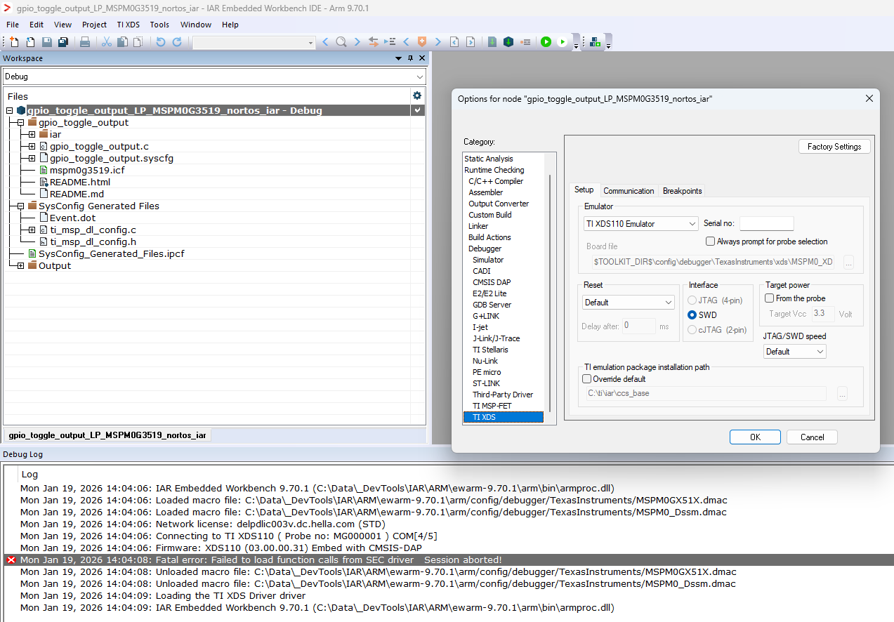

Now, I am referring to MSPM0 MCUs Development Guide and start start development on MSPM0G3519  evaluation board and faced wiht the issue "Fatal error: Failed to load function calls from SEC driver   Session aborted!" as image below.
Could you kindly help to give some suggestion?

    I haven't meet this issues before. Are you using LP-MSPM0G3519 with on-board debugger?
    Can you try another debugger if you have, for example J-Link. Another approach is that please try connect the board with latest CCS or UNIFLASH to upgrade the XDS110 firmware version to see if it helps.
    According to the error log, this looks like some driver file is missed by your IAR tool. I suggest you try uninstall and install again.
