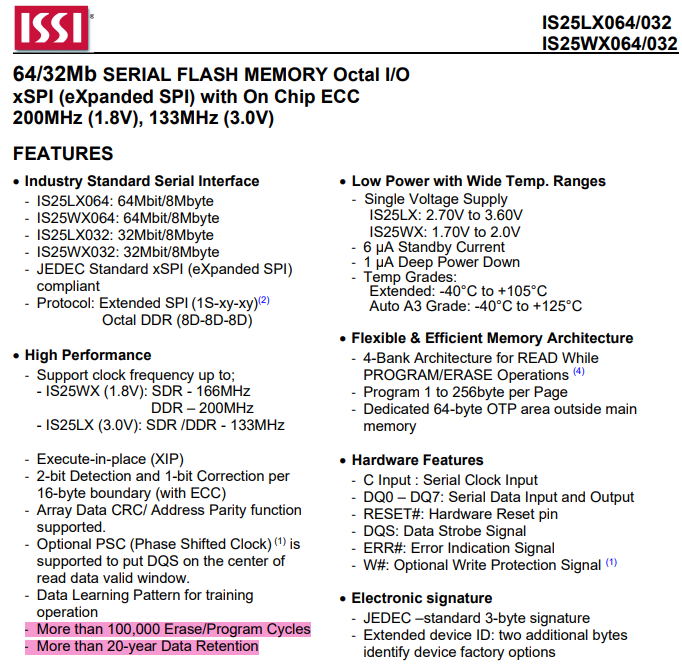

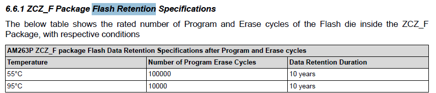

I am reviewing the datasheet for AM263P4-Q1. It states that the built-in Flash ROM is IS25LX064.
1) Is the temperature specified a junction temperature?
2) If No.1 is YES, can you provide information on the program cycle and lifespan at temperatures like 105°C and 125°C?
3) Why does the Flash Retention performance degrade compared to the standalone IS25LX064?

  • Hi Yu Sato,
    Thank you for your patience. I've received confirmation regarding your inquiry about the IS25LX064 flash specifications at elevated temperatures.
    I'd like to clarify that the data retention specifications mentioned in the IS25LX064 ISSI flash datasheet (20 years and 100K cycles) are not specified for the worst-case temperature (125°C). There is no performance degradation in the SIP implementation compared to the standalone flash.
    Regarding your specific question about data retention at 105°C and 125°C, I can now provide more detailed information. The data retention policy at these temperatures depends significantly on the number of Program/Erase (P/E) cycles:
    1. For P/E cycles ≤ 10:
    - At 105°C: Data retention of approximately 30 years
    - At 125°C: Data retention of approximately 8 years
    2. For P/E cycles ≤ 10,000:
    - At 105°C: Data retention of approximately 7 years
    - At 125°C: Data retention of approximately 1 year
    3. For P/E cycles ≤ 100,000:
    - At 105°C: Data retention of approximately 1 year
    - At 125°C: Data retention of approximately 2 months
    This information should help you determine the appropriate design considerations for your specific application, especially if you're operating at these elevated temperatures for extended periods.
    Please let me know if you have any further questions or require additional clarification.
    Mayank Shadwani
