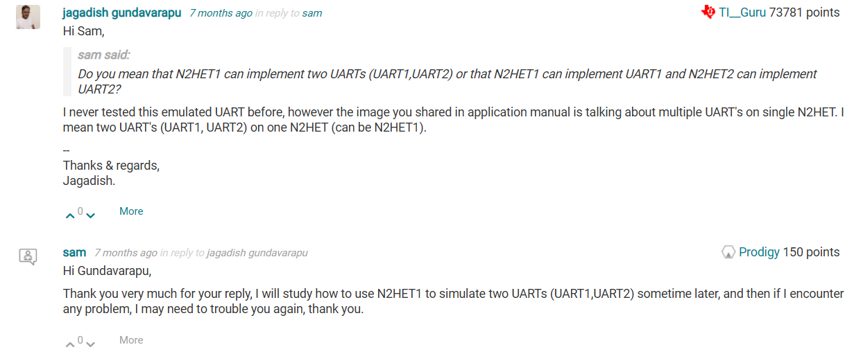

I have read the following post:
https://e2e.ti.com/support/microcontrollers/arm-based-microcontrollers-group/arm-based-microcontrollers/f/arm-based-microcontrollers-forum/1504690/tms570ls0432-n2het-emulated-uart
I may need to use the N2HET1 to emulate three serial ports. Is this feasible? If serial ports are emulated on the N2HET1, can the other HET pins still be operated as regular I/O pins? (Using the gioSetBit function)
