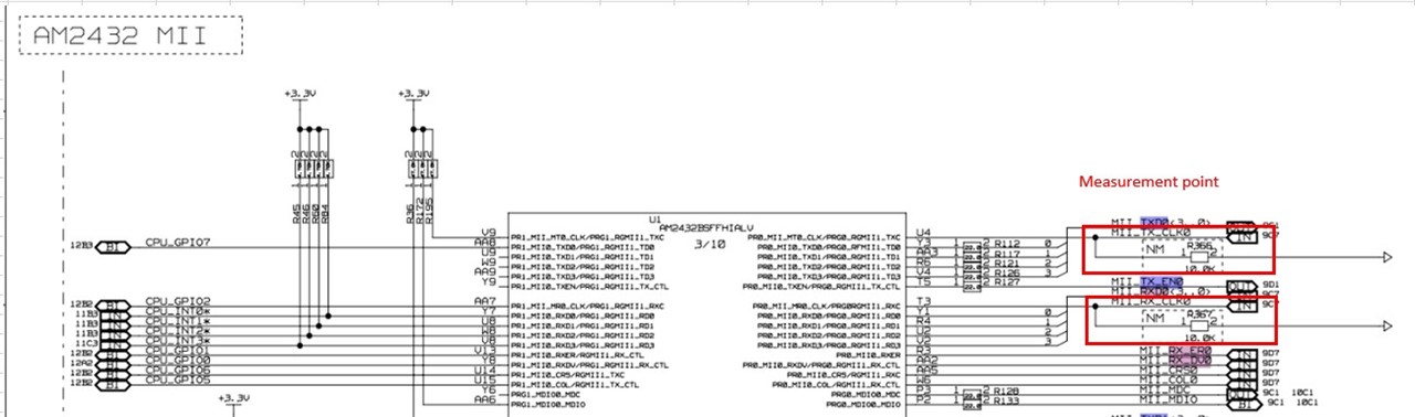

My customer is now evaluating EtherCAT SubDevice of ISDK 11.0.0.13 on AM2432 by connecting some kinds of MainDevices.
As for the connection with TwinCAT, they were able to confirm that the EtherCAT communication transitions to Op after detection by bus search as expected.
However, in the combination with CTT tool, SubDevice is not detected by Search.
They checked the packet data by Wireshark when the Search failed, and found that the SubDevice on their custom board did not respond at all to the first BWR command issued by the CTT tool.
When they compared the contents of packets on the CTT tool and TwinCAT, there was the difference in the MAC destination of the BWR. That was Unicast (01:01:05:01:05:01:00:00) in the case of TwinCAT, but that’s BroadCast (FF:FF:FF:FF:FF:FF:FF) in the CTT tool.
Their custom board as SubDevice is directly connected with MainDevice (PC).
From these results, they’re presuming that Broadcast packets are being read/discarded on the AM2432, but they’re not sure.
Could you provide them any advice or suggestion to figure out a root cause and to solve this issue ?

  • Additional information,
    They confirmed the Wireshark logs by connecting PC with the OUT port (Port 1) on their custom board when the above issue occurred.
    The BWR packets issued by the CTT tool could be retrieved. At this time, the WC (Working Counter) is incrementing by one count.
    ESC DL STATUS (0x0110) before connecting PC to OUT port is 0x5611, it shows only Port 0 is on the Link state.
    ESC DL STATUS (0x0110) after connecting PC to OUT port is 0x5a31, it shows Port 0 and 1 are on the Link state.
    From these results, it seems that the Data write and the Command response to BWR command processing:0x0100,0x0101 are not working even though the ESC can receive BWR commands from the CTT tool as EtherCAT packets.

    So to summarize the details provided:
    Issue Summary
    • Problem: AM2432 custom board with TI EtherCAT SubDevice Stack cannot be detected by CTT tool during bus search, despite working correctly with TwinCAT.
    Configuration:
    • Hardware: AM2432 custom board (ported from TMDS243EVM)
    • Software: IC SDK 11.0.0.13 on AM2432
    • Connection: Direct connection between AM2432 custom board and PC running CTT tool
    • PHY Configuration: Port0=0, Port1=1
    • Sysconfig:
      • MDIO Manual Mode Base Address: 0x10E40
      • MDIO Manual Mode Link Status Update: PHY Polling Based
      • Enhanced Link: Disabled
    Behavioral Findings:
    • Works with TwinCAT, Fails with CTT
      • TwinCAT: SubDevice is detected by bus search and communication transitions to Op state as expected
      • CTT Tool: SubDevice is NOT detected on Port0 of SubDevice
      • SubDevice does not respond at all to the first BWR command issued by CTT tool
    • Key Difference in BWR Packets:
      • TwinCAT BWR: MAC destination = Unicast (01:01:05:01:05:01:00:00)
      • CTT Tool BWR: MAC destination = Broadcast (FF:FF:FF:FF:FF:FF:FF:FF)
    • ESC DL Status Register (0x0110) Behavior
      • PC connected to IN port: 0x5611 (only Port 0 shows Link state)
      • After connecting PC to OUT port: 0x5a31 (Port 0 and Port 1 both show Link state)
      • Link state changes correctly depending on Port0 connection status
    • Frame Reception Evidence
      • BWR packets from CTT tool can be retrieved via Wireshark on OUT port (Port 1) - Does this mean that scan is successful with Port1 only connected?
      • Port0 frame counter is incrementing - Is the incremented value matching the number of frames in the wireshark log?
    • PHY Configuration
      • DL status updates as expected → PHY is configured correctly
      • Port0 frame counter increments → BWR frames are being received, not discarded
    Can you also provide the ICSS Memory Dump (0x30000000 - 0x30040000) ?
    Please provide the PHY register dump as well to cross verify the configurations. Also which PHY is the customer using in the custom board?
    Has the customer evaluated the the same on TMDS243EVM ICSSG0 instance?

    Thank you for summarizing the current situation. The customer would like to correct some your comments and to answer your questions.
    Please see their feedbacks below.
    It's not TI stack. We've ported the code which they created by using Beckhoff SSC tool by referring to EtherCAT SubDevice Beckoff SSC Demo in the Industrial Communications SDK. We confirmed that this stack worked correctly on EVM.
    No, that is not correct. The result is from testing with the following incorrect EtherCAT configuration:
    CTT tool – IN port (Port 0) – OUT port (Port 1) – PC (Wireshark)
    With this configuration, even if everything works correctly, BWR packets are expected to reach the PC (Wireshark) and then be discarded.
    However, the fact that the packets reached the PC (Wireshark) suggests that they at least reached the AM2432.
    We use DP83822.
    We have not evaluated the ICSSG0 instance on the EVM.
    Our understanding is that the ICSSG0 instance cannot be used due to the hardware configuration.
    For other your questions, we'll let you know once we confirmed.

    Can they verify MII CLK from PHY in this case?
     This is the MII CLK waveform.
