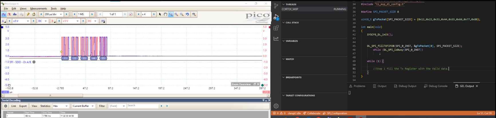

I am working on MSPM0G3519 and DRV8363S.
I started with basic SPI peripheral initialization to verify data sent from PICO.
I sent 0x11, 0x22, 0x33, 0x44, 0x55, 0x66, 0x77, 0x88 but only received
0x11, 0x22, 0x33, 0x44, 0x55. Also, I have verified that the return value from the function DL_SPI_fillTXFIFO8 is 5.
Why are only 5 bytes transmitted?

  • I could not find the thread, but I believe that this is due to the FIFO. You can only send 5 bytes (1 immediate and 4 in the FIFO) before you have to wait for the FIFO to clear to send the next batch. Why the 8 byte transmit fails, I have no idea.
  • The SPI TX FIFO is only 4 entries [Ref TRM (SLAU846C) Sec 25.2.2.5].
    You get the "extra" (5th) entry since as soon as the FIFO goes non-empty it pops the first entry into the FIFO Shift Register.
    DL_SPI_transmitDataBlocking8() waits for the transmission to complete After loading the FIFO, so there's never more than 1 entry there.

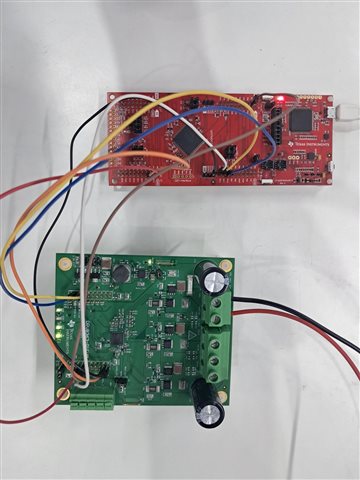

    3. Verified the PICO pin data using the Picoscope. There are 48 rising edge (Each frame = 24 clock rising edge)
    4. Now, connected the DRV8363 with proper pin mapping. [SPI CLK to DRV SCLK, SPI CS to nSCS, SPI PICO to SDI, SPI POCI to SDO]
    Also, the nSLEEP made HIGH to clear Fault Pin after power up. Refer the below MSPM0 and DRV setup,
    When I send the read frame [0x810000] to DRV there is no response (nothing recieved in Rx register) why? Even I achieved delay between each frame sent to MSPM0 to DRV (Refer the Picoscope data).
    I am not getting the data from the DRV even after sending required frames?
    Kindly help me on this.

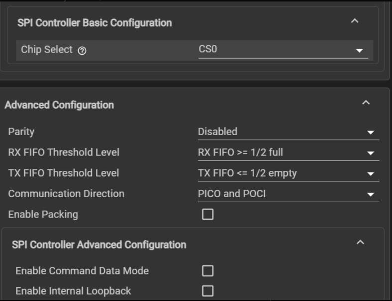

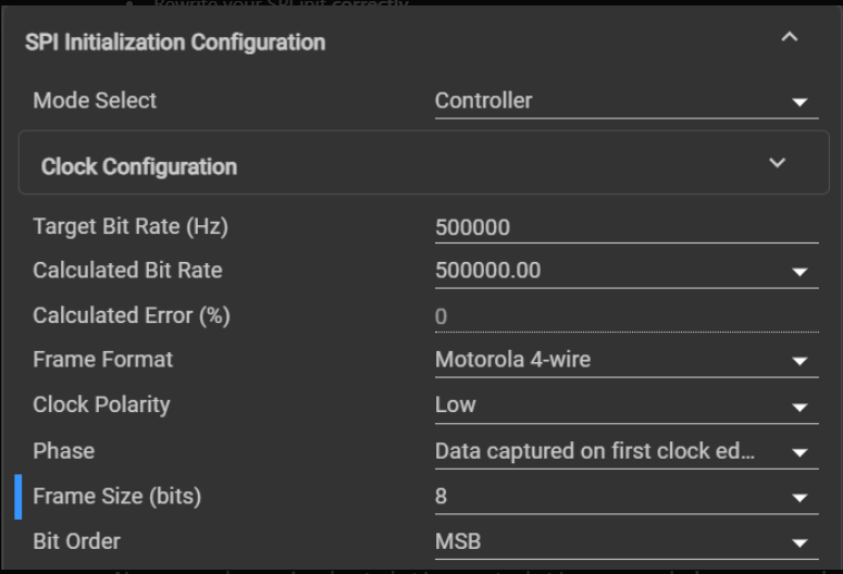

  • Mode "Motorola 4-wire" implies a hardware /CS (PC7 in your case). The SPI unit will de-assert nSCS between bytes if either (a) SPH=0 or (b) the TX FIFO goes empty [Ref TRM (SLAU846C) Sec 25.2.3.1]. While DRV8363 datasheet (SLVSHQ3) Sec 6.6.1 doesn't say it explicitly, it suggests that nSCS has to stay asserted for all 3 (or 4 with CRC) bytes. In general: You should use a GPIO for nSCS (you can use PC7 if you want) rather than the hardware /CS.
    To get you going right now: It appears that you're using SPH=1 ("captured on second clock edge"), which keeps /CS asserted over a "continuous back-to-back" sequence of bytes, meaning "the TX FIFO never goes empty". You can (usually) accomplish this by pre-loading the TX FIFO. As near as I can tell, DRV8363 transactions are all 3-byte (or 4-byte with CRC), which Will fit in the FIFO.
    So I suggest you go back to using DL_SPI_fillTXFIFO8() but limit yourself to 3 (or 4) bytes at a time. [Even this is not guaranteed, so long-term you should consider using a GPIO for /CS.]

  • 1A) I don't see anything obviously wrong with your code. Maybe check your wiring (again)?
    1B) Supposing that the lower trace is /CS, I notice that it's low (asserted) until just before the transaction starts, and very briefly goes high before going low again for the transfer. At 1Msps I can't tell how long it is, but data sheet (SLVSHQ3) Sec 5.6 requires it to be high for at least ~0.5usec. I suggest you set your /CS pin initially =1 (I think Sysconfig can do this) which should assure /CS idles high even at startup.
