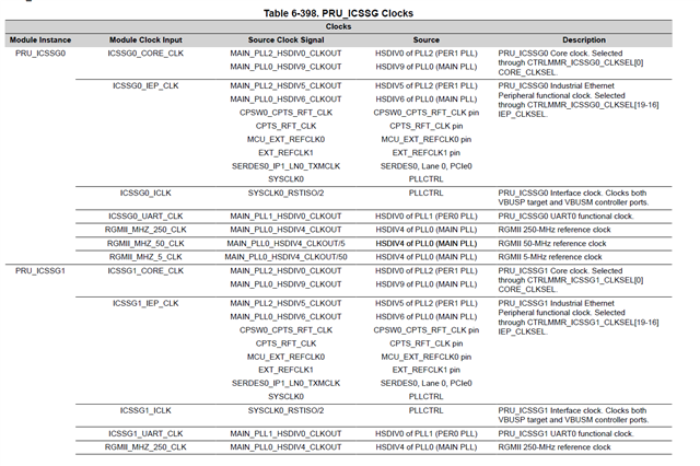

  • Hello yall,
    Apologies for the delays here. Looking at the TRM, MAIN_PLL2_HSDIV5 is one potential clock source for the IEP counter. If you are using protocols at 100Mbit, perhaps the PRU Ethernet firmware would set the IEP counter to use 200MHz? I am not sure off the top of my head:
    First, let's verify whether the IEP counter is even being configured to use MAIN_PLL2_HSDIV5. Please check CTRLMMR_ICSSG0_CLKSEL[19-16]
    IEP_CLKSEL to see which clock is getting muxed to the IEP counter, and ICSSG_IEPCLK_REG[0] IEP_OCP_CLK_EN to see whether the IEP_CLK input is getting muxed to come from the IEP specific clocks, or from the CORE_CLK.
    In the TRM, search for
    CTRLMMR_ICSSG0_CLKSEL Register
    or
    CTRLMMR_ICSSG1_CLKSEL Register
    and
    ICSSG_IEPCLK_REG Register
    Nick
