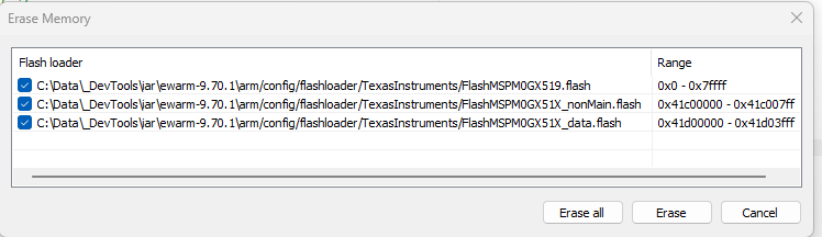

Current'y I'm trying to use CMSIS DAP on IAR to debug my launchpad kit. I'm trying to erase the memory at the moment before flashing new software. When I choose erase memory, it shows this option
Do you know which zone shall I keep ? Which zone shall I erase ?

    Please only erase the range 0x0-0x7ffff, which is used for your main code.
    The range of 0x41c0.0000 - 0x41c0.07ff is used for NONMAIN, do not erase unless you want to prorgam a new NONMAIN configuration.
    The range of 0x41d0.0000 - 0x41d0.3fff is used for data bank, it can only store the data, and can be erased depends on users' usage.
