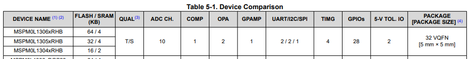

Hello experts,
MSPM0L1305 have 1 GPAMP and 2 OPA as per the comparison table shown below.
However, some pins are common so it is not possible to use 2 OPA and 1 GPAMP simultaneously.
Is my understanding correct? If so, please add a note in device comparison table, as it can be confusing when selecting the device.
Is there any device in MSPM0L series that allows use of 3 Amps?

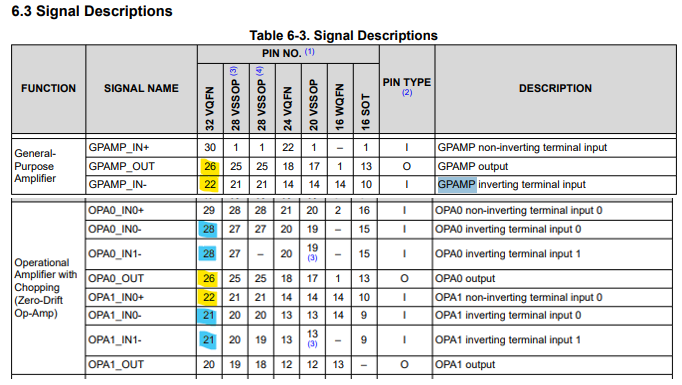

(1) Pin 26 and 22 are common between GPAMP and OPA.
(2) OPAx_IN0+ and OPAx_IN1- pins are common.
