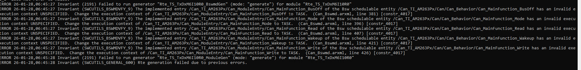

Currently we are working on MCAL_AM263Px_11_01_00_11, in bswmd.arxml files for the MCAL Modules the main function execution is not mapped to TASK. for main function execution the context should be set to TASK instead of UNSPECIFIED.
If the main function is not assigned to a Task we are getting compilation issue as below:
Can_Bswmd.arxml_EB_Update.txt
Can_Bswmd.arxml_origin_version.txt
I have added the EB_Update for reference, can you please check and provide your feedback.
