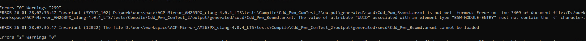

Hello Team,
Currently we are working on MCAL_AM263Px_11_01_00_11,in bswmd.arxml file for cdd_Pwm Module the <BSW-MODULE-ENTRY UUID="19e5d126-d261-46d2-a470-91d5ca848fda>tag, the closing double-quote (") for the UUID attribute is missing. compilation issue occurs because of this closing tag.
I have already taken care this by closing the tag.
