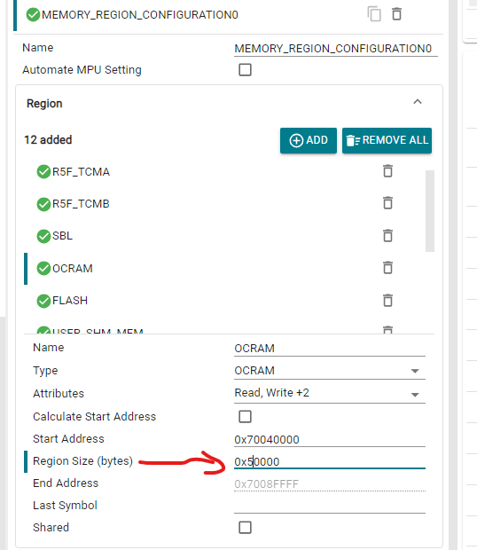

I recently had to enlarge the amount of RAM allocated to my program .text section. So initially I went into sysconfig and increased the pre existing OCRAM memory region from 0x40000 bytes to 0x50000 bytes.
However, this caused a prefetch abort fault during the first register write in OSPI_lld_phyBasicConfig(..) within the Board_flashOpen() call I make at the beginning of my program.
I also realized that the OCRAM banks are seperated out at the following intervals:
L2OCRAM_BANK0 --- start: 0x7000 0000 --- end: 0x7007 FFFF --- size: 512 KB
L2OCRAM_BANK1 --- start: 0x7008 0000 --- end: 0x700F FFFF --- size: 512 KB
L2OCRAM_BANK2 --- start: 0x7010 0000 --- end: 0x7017 FFFF --- size: 512 KB
L2OCRAM_BANK3 --- start: 0x7018 0000 --- end: 0x701F FFFF --- size: 512 KB
And thus my current OCRAM memory region which started at 0x70040000 and ended at 0x7008FFFF defined in the sysconfig overlaped between L2OCRAM_BANK0 and L2OCRAM_BANK1.

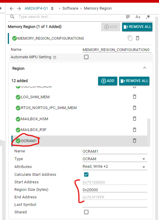

Thinking that this may be an issue I created a new memory region for my linker called OCRAM1 set only inside of L2OCRAM_BANK3. i also set my first OCRAM memory region back to just 0x40000 bytes in size so its only within L2OCRAM_BANK1. I then added OCRAM1 as the memory region used for the section requiring more space.
After making these changes I no longer get the prefetch abort fault and my application runs as expected.
My question is: are memory regions defined for the linker only allowed to be within a single OCRAM bank, i.e. a single memory region can't overlap two OCRAM banks?
Thank you

    I don't believe there is anything placed across the boundary. This is what I see stored at the boundary edge when I revert back to just having a single 0x50000 sized OCRAM region that crashes the program:
    addr:               size:
    7007fff4          0000000c        --HOLE-- [fill = 0]
    70080000       00000044       drivers.am263px.r5f.ti-arm-clang.nortos.debug.lib : soc_rcm.obj (.text.SOC_rcmExtract8)

    MEMORY
        R5F_VECS   : ORIGIN = 0x0 , LENGTH = 0x40
        R5F_TCMA   : ORIGIN = 0x40 , LENGTH = 0x7FC0
        R5F_TCMB   : ORIGIN = 0x80000 , LENGTH = 0x8000
        SBL   : ORIGIN = 0x70000000 , LENGTH = 0x40000
        OCRAM   : ORIGIN = 0x70040000 , LENGTH = 0x50000
        USER_SHM_MEM   : ORIGIN = 0x701D0000 , LENGTH = 0x4000
        LOG_SHM_MEM   : ORIGIN = 0x701D4000 , LENGTH = 0x4000
        FLASH   : ORIGIN = 0x60000000 , LENGTH = 0xF0000
        RTOS_NORTOS_IPC_SHM_MEM   : ORIGIN = 0x72000000 , LENGTH = 0x3E80
        MAILBOX_HSM   : ORIGIN = 0x44000000 , LENGTH = 0x3CE
        MAILBOX_R5F   : ORIGIN = 0x44000400 , LENGTH = 0x3CE

    region1.$name                                = "MEMORY_REGION_CONFIGURATION0";
    region1.memory_region.create(11);
    region1.memory_region[0].type                = "TCMA";
    region1.memory_region[0].$name               = "R5F_VECS";
    region1.memory_region[0].size                = 0x40;
    region1.memory_region[0].auto                = false;
    region1.memory_region[1].type                = "TCMA";
    region1.memory_region[1].$name               = "R5F_TCMA";
    region1.memory_region[1].size                = 0x7FC0;
    region1.memory_region[2].type                = "TCMB";
    region1.memory_region[2].size                = 0x8000;
    region1.memory_region[2].$name               = "R5F_TCMB";
    region1.memory_region[3].$name               = "SBL";
    region1.memory_region[3].auto                = false;
    region1.memory_region[3].size                = 0x40000;
    region1.memory_region[4].$name               = "OCRAM";
    region1.memory_region[4].manualStartAddress  = 0x70040000;
    region1.memory_region[4].auto                = false;
    region1.memory_region[4].size                = 0x50000;
    region1.memory_region[5].type                = "FLASH";
    region1.memory_region[5].auto                = false;
    region1.memory_region[5].$name               = "FLASH";
    region1.memory_region[5].size                = 0xF0000;

    section2.load_memory                  = "OCRAM";
    section2.$name                        = "Text Segments";
    section2.output_section.create(5);
    section2.output_section[0].$name      = ".text.hwi";
    section2.output_section[0].palignment = true;
    section2.output_section[1].$name      = ".text.cache";
    section2.output_section[1].palignment = true;
    section2.output_section[2].$name      = ".text.mpu";
    section2.output_section[2].palignment = true;
    section2.output_section[3].$name      = ".text.boot";
    section2.output_section[3].palignment = true;
    section2.output_section[4].$name      = ".text:abort";
    section2.output_section[4].palignment = true;
    section3.load_memory                   = "OCRAM";
    section3.$name                         = "Code and Read-Only Data";
    section3.select_multiple_regions       = true;
    section3.output_section.create(2);
    section3.output_section[0].$name       = ".text";
    section3.output_section[0].palignment  = true;
    section3.output_section[1].$name       = ".rodata";
    section3.output_section[1].palignment  = true;
    section3.split_priority[0].$name       = "Memory Region0";
    section3.split_priority[0].load_memory = "OCRAM";

    Thanks for the information,
    Will it be possible for you to share your application so I can debug it, or parallely, can you please share:
    1. Map file
    2. When abort occurs, in disassembly, go to lr-8 instruction in the disassembly file. And see the instruction that was executed, and
    open your registers window in CCS, get the values for IFAR, IFSR, SPSR, PRC, SP and (LR-8) register from the R5F CPU core registers
    Based on this, we can exactly see what caused the abort.
    Shaunak
