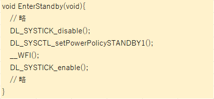

Our customer faced the issue when they tried to enter the STANDBY1 mode as using following code.
After executed DL_SYSCTL_setPowerPolicySTANDBY1(); , Program Counter is waiting at __WFI(); So. cusotmer thought it should be entered to STANDBY1 mode.

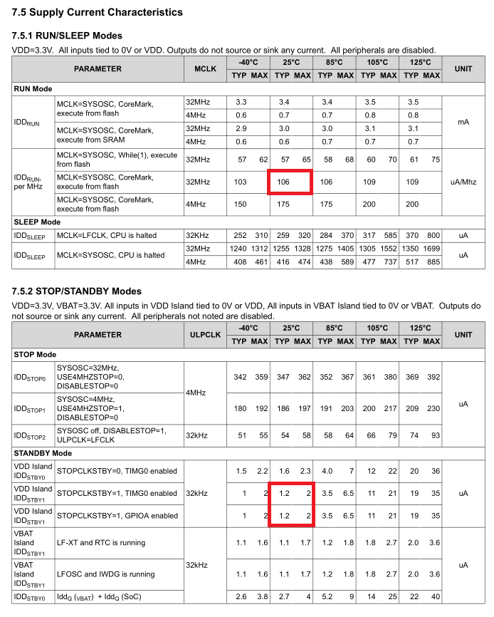

But they measured the current. The current was 2120uA. It should be around 1~2uA. It means that it doen't change to STANDBY1 mode. And customer thought that 2120uA is RUN mode. Because 2120uA = 106 uA/MHz * 20MHz(current clock speed is 20MHz). So Could you advice them the correct steps how to enter STANDBY1 mode.

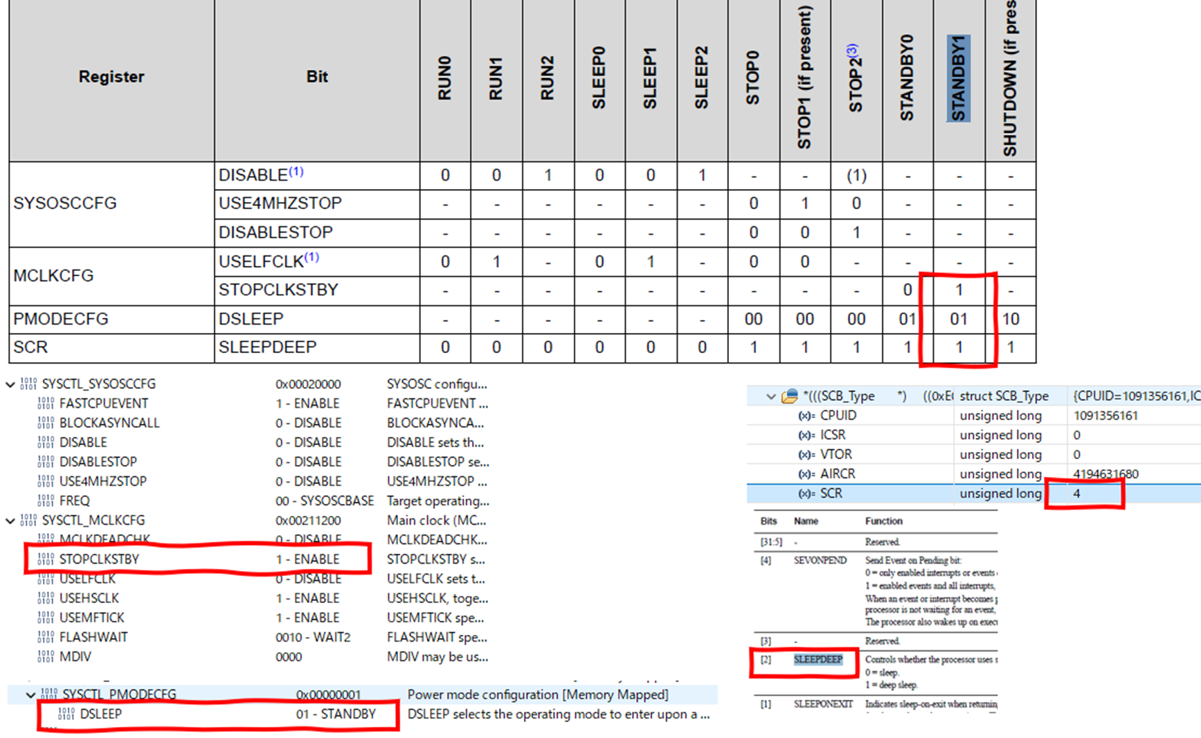

And they checked the register as following. It seems there is no problem.

    UART RX was low, but we disabled UART/DMA which generated by SysConfig, it seems the statement moves to Standby. (waveform of SysOSC from CLKOUT was stopped).
    -> We think there is possibility that there are missing configuration of register for UART/DMA before statement moves to Standby mode. Could you consider this point as well.
