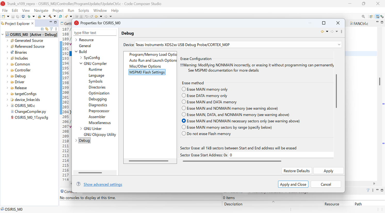

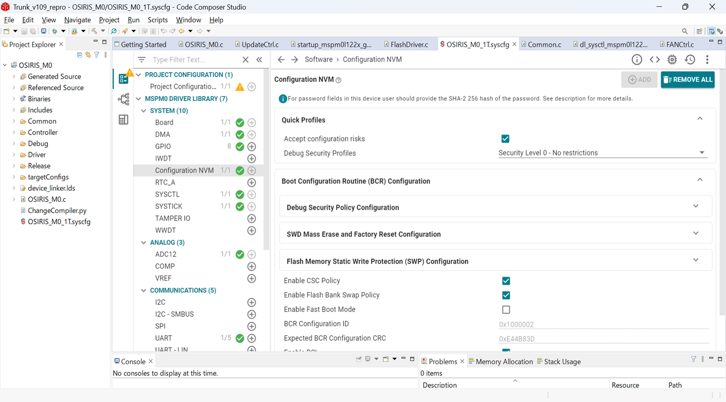

Here is configration of Sysfg.
Configration for debuging.

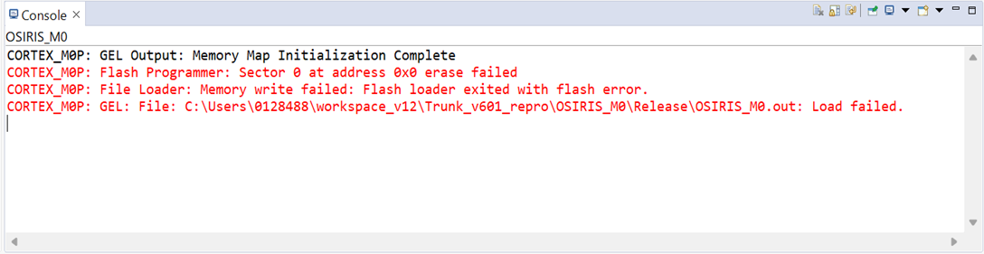

Following error happens during the loading the out file after executed Bank Swap(Current Bank is 1).

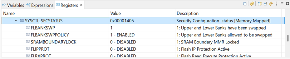

Register value.

    It looks like that when bank swap is enabled, the logic bank 0 is auto write protected, and if you are trying to program (by Uniflash or CCS) MCU for address 0x00000-0x10000 (logic bank 0), it will show erase error due to logic bank 0 is protected.
    There are two ways for this situation:
    1. If only the application firmware need to be updated, then the firmware could be updated to 0x10000 - 0x20000 (logic bank 1) address, it should work.
    2. If the boot program also need to be updated, then customer needs to take a factory reset firstly and then program the boot firmware.
