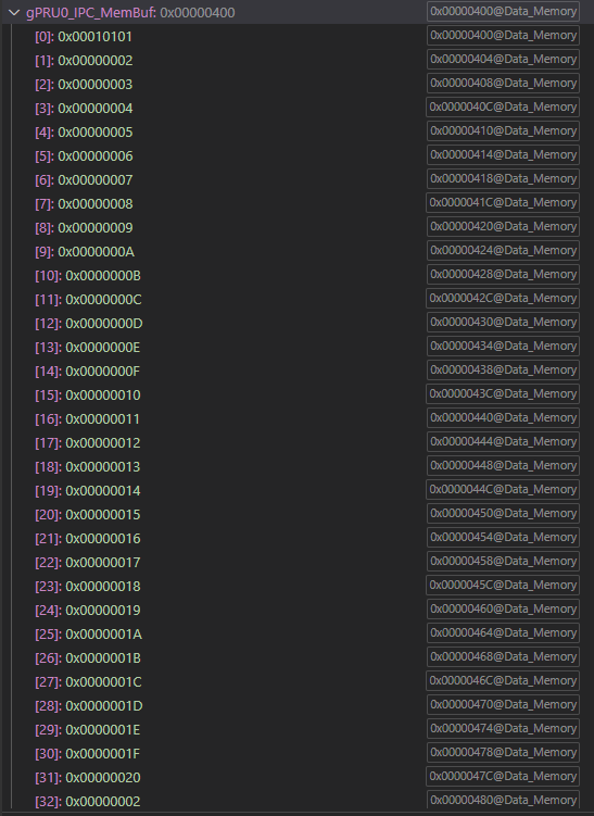

  • Hello Tushar,
    I have implemented the PRU IPC in my code and it's working as expected. However, we are facing some issues during the data transfer.
    We performed two cases in our application and observed that one is successfully executed and second one fails.
    CASE 0: (READ & WRITE 128BYTES (Block size: 32) - Block 0 of Buffer0
    1.  In R5F Project, configured PRU IPC as mentioned in below picture.
    2. Allocated memory region for share memory for address 0x30010000.
    3. In PRU Project, the linker script of PRU Project is updated based on the memory region allocated for shared memory in R5F Project. Below mentioned image shows that how linker is edited.
    3. For data transmission and receiving, R5F Core writes 128Bytes (32 Words) in a shared memory (Add: 0x30010000) and generate an interrupt event to PRU0 core.
    4.  PRU0 Firmware polling interrupt status register continuously and check that does interrupt occurred or not. Once the interrupt occurred then it reads data from the shared memory (Add: 0x30010000) and store in a buffer.
    5. Once the data is read, PRU0 firmware send an interrupt to R5F core for acknowledging that the data is received successfully.
    The case0 is working as expected.

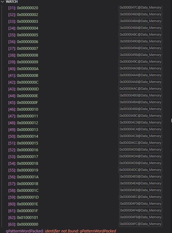

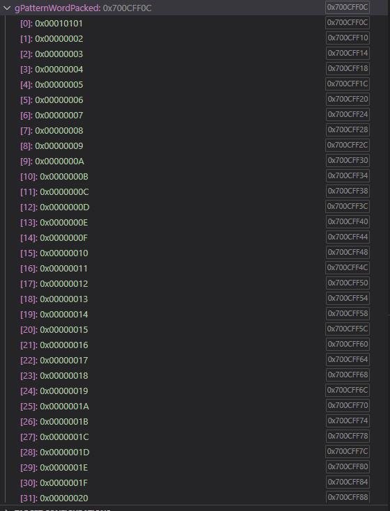

    CASE 0: (READ & WRITE 256BYTES (Block size: 64) - Block 0 of Buffer0
    2. Step 2 & 3 is same as mentioned in case0.
    3. For data transmission and receiving, R5F Core writes 256Bytes (64 Words) in a shared memory (Add: 0x30010000) and generate an interrupt event to PRU0 core.
    In result, the PRU firmware is not reading greater than 128bytes from a shared memory.
    Below is the data reading logic in PRU Firmware:
    PRU_IPC_MEM_BASE = 0x30010000
    As I observed the memory data in R5F Firmware for a shared memory, R5F Core is writing 256 bytes of data successfully. (Address: 0x30010000 to 0x30010100)
    Below images represent the data which I'm writing in a shared memory (In R5F Project).
    Below images represents the data I have read from the shared memory in PRU Firmware:
    It can be observed that the PRU Firmware is reading first 128 bytes (32 Words) correctly, but after it, it is reading the values from 0x30010000 instead of 0x30010080.
    What could be the reason/bug behind it? Do I configure the PRU IPC correctly or not.
    Kindly review the above-mentioned images and provide the response as soon as possible.
    If you have an example which shows that how I can send more than 128bytes, then kindly share it with us.

    Hypothesis: maybe memcpy is not generating the correct assembly read instructions
    A single Load Byte Burst command (LBBO or LBCO) can only copy up to 124 bytes of data (refer to https://www.ti.com/lit/spruij2 ).
    If memcpy is smart enough, then I would expect it to break up the read command across multiple instructions, and update the read offset for each new instruction. But perhaps it is doing something else.
